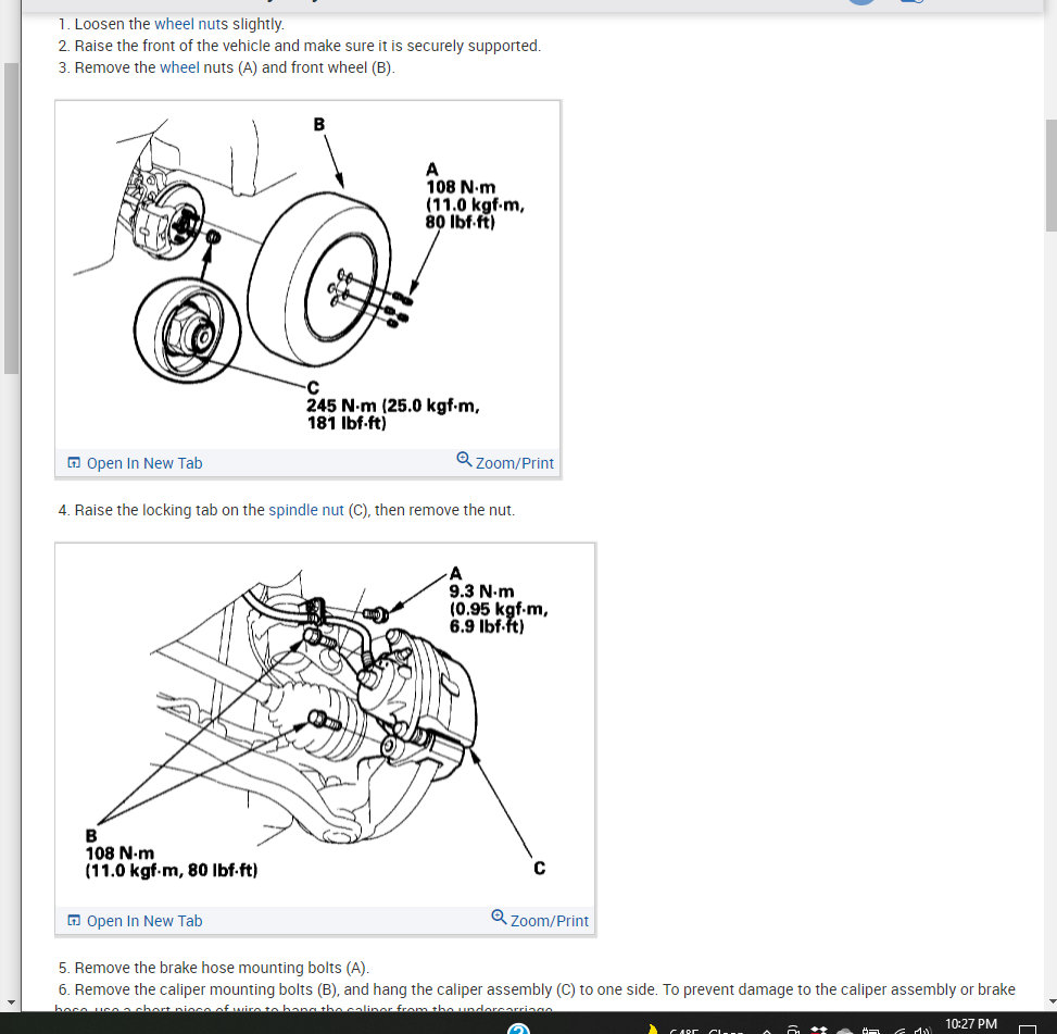

Good afternoon,

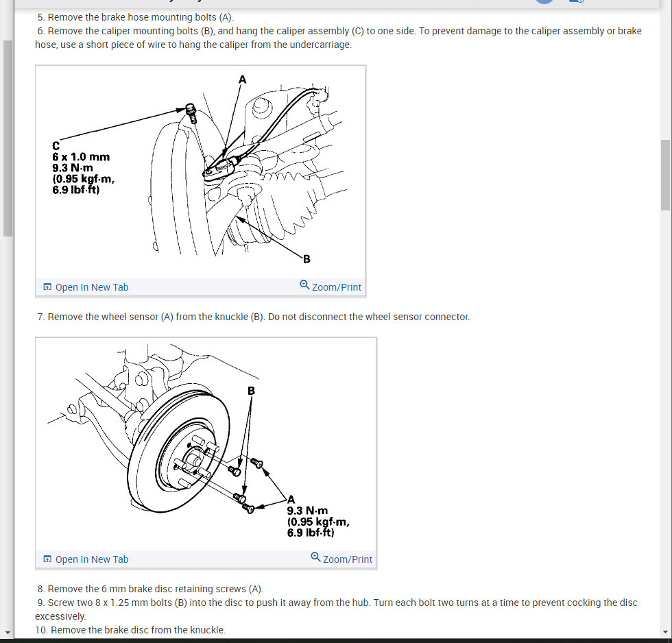

Can you please give me instructions on how to remove the wheel studs? I wish to repair them. Any help will be greatly appreciated. Thanks.
Oct 15, 2008 at 3:07 PM

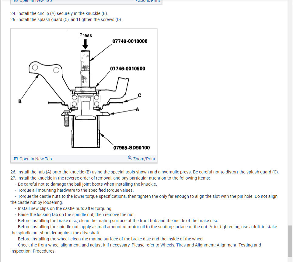

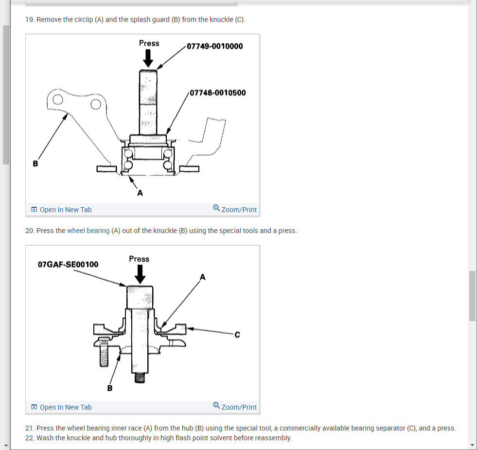

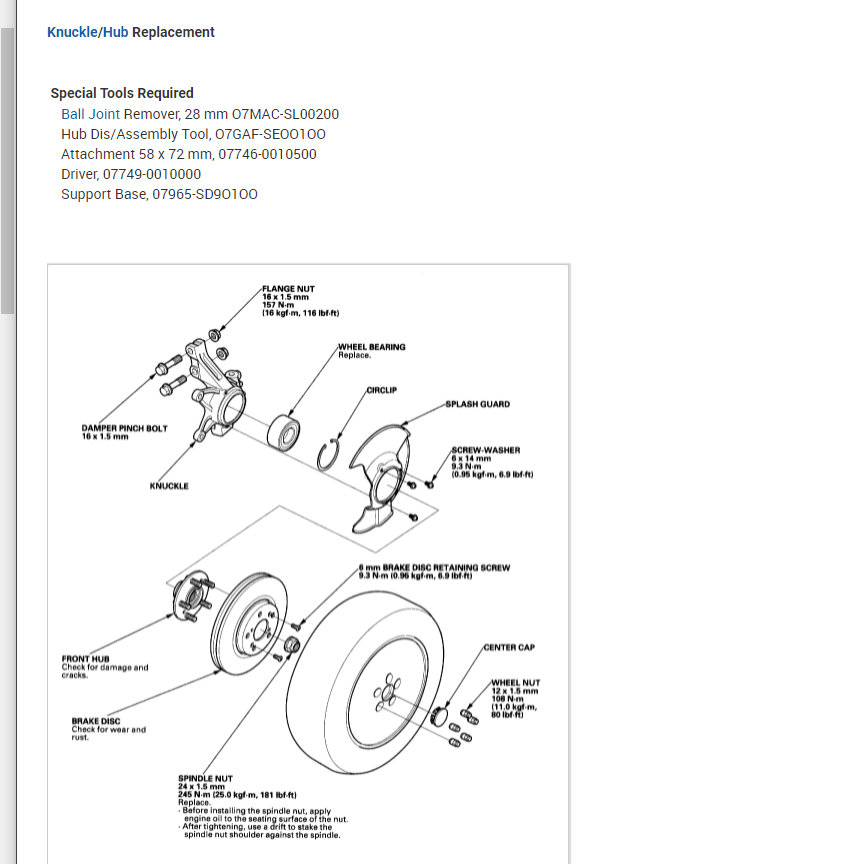

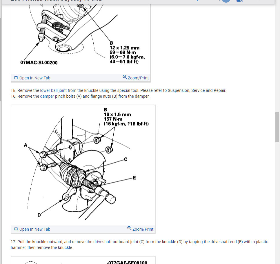

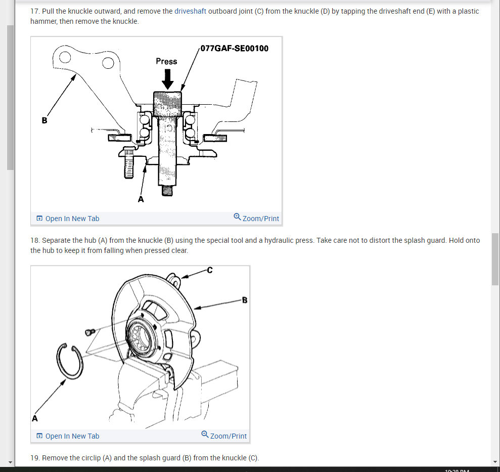

I suspect you have to replace the studs because they were over torqued. That is a pretty common issue so here is a guide that will help with doing this properly:
https://www.youtube.com/watch?v=_HIaE1MyDiw
Also, here is a video on how to replace the studs on a different vehicle but it is going to be similar on your vehicle:
https://youtu.be/LSZ8P0wrQX8

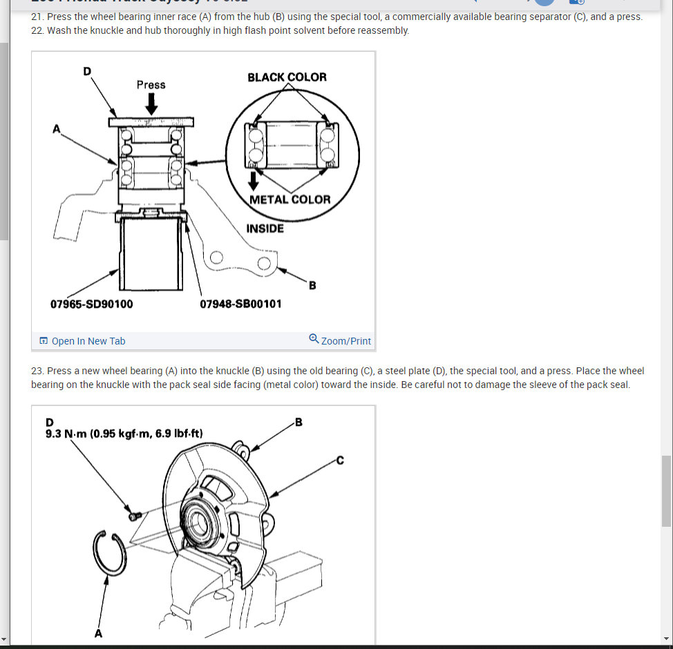

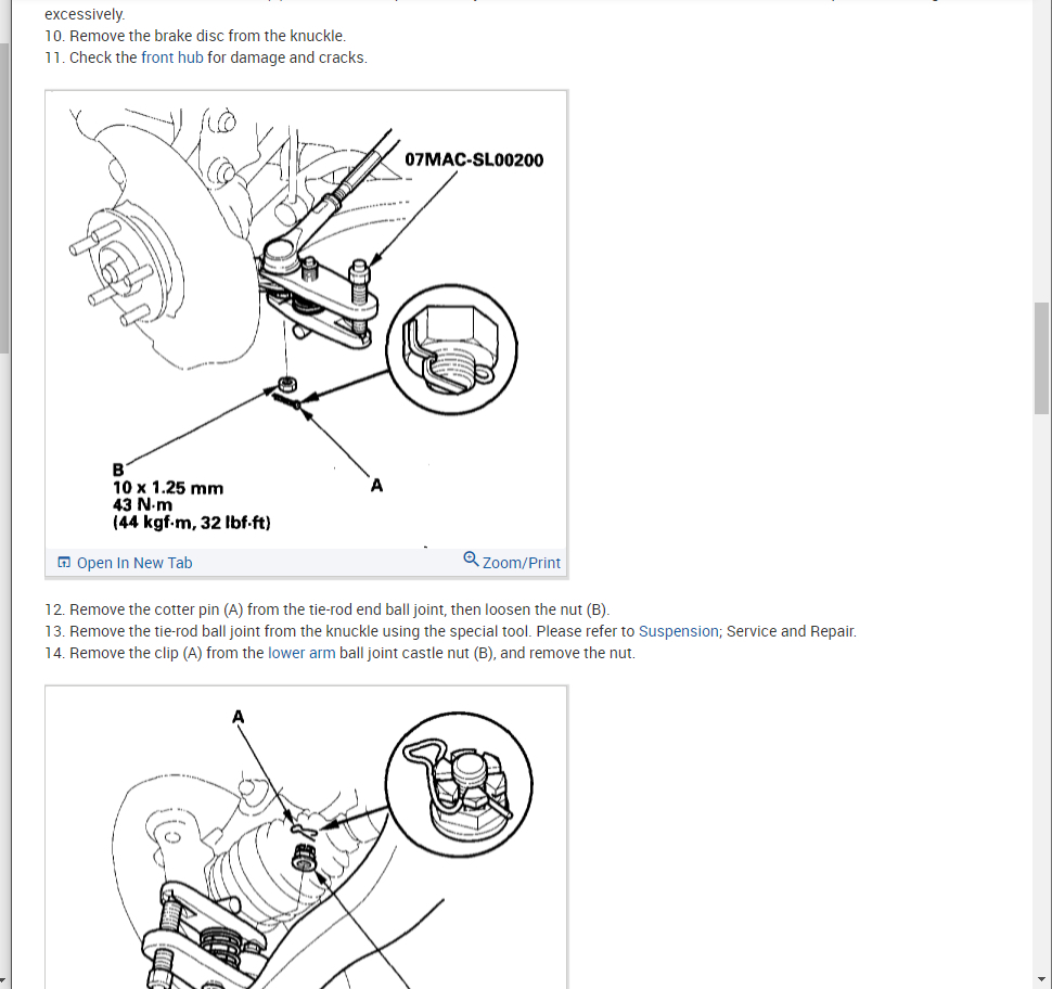

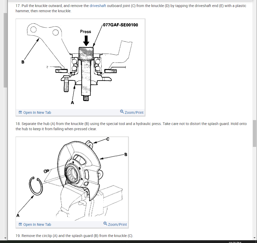

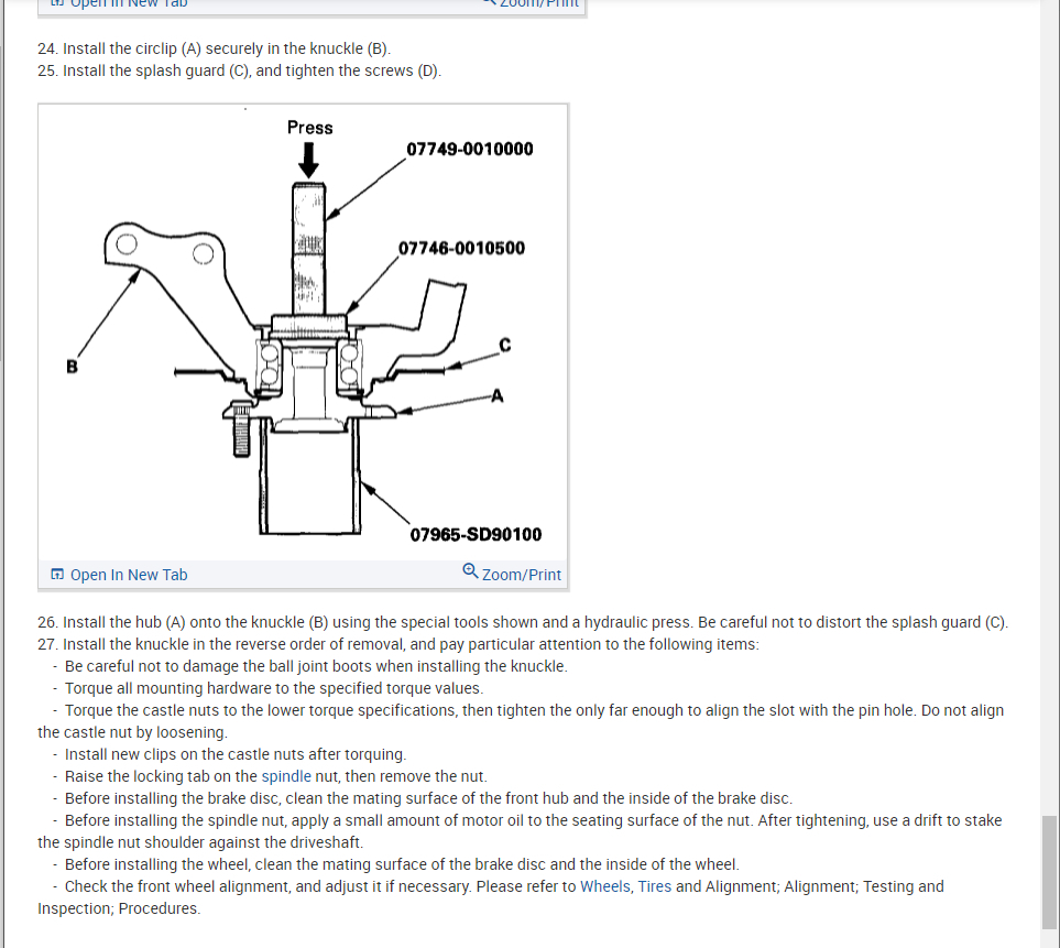

However, if it were me, replacing the hub would be easier so I would go that route.
I attached the process below. Please run through this info and let us know what you find with this. Thanks
