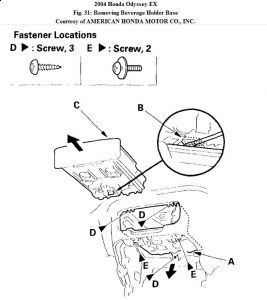

I want to replace the sponge on my cup holders.
I am unable to get the top piece off. The piece underneath the top piece has 2 screws holding it
I can spread the top piece but it will not snap loose
HELP

Hi lewdininny, Here are the procedures, let me know you are at which point. BEVERAGE HOLDER BASE REMOVAL/INSTALLATION NOTE: "¢ Take care not to scratch the dashboard and related parts "¢ Put on gloves to protect your hands. 1 . Make sure you have the anti -theft codes for the radio and the navigation system, then write down the frequencies for the preset buttons. 2 . Remove these items: "¢ Center lower console. "¢ Center panel "¢ Audio unit "¢ Display unit (with navigation system) 3 . Remove the beverage holder base (A). â—¦ 1 Detach the hook (B) from under the beverage holder (C). â—¦ 2 Pull the beverage holder out. â—¦ 3 Remove the screws (D, E). â—¦ 4 Remove the beverage holder base from the center lower console opening.
https://images.2carpros.com/forum/automotive_pictures/192750_BeverageHolder04OdysseyFig31_1.jpg
4 . Install the beverage holder base in the reverse order of removal, and enter the anti -theft code for the radio and the navigation system, then enter the customer's radio station presets.

The console between the front seats is sandwiched together and the two parts are held in place by several Phillips head screws. I have gotten to them all by laying on the passenger floor and contorting my arm underneath the folding console to get at them. You will need a #2 Phillips - most likely a regular and a stubby one. They do NOT snap apart.
