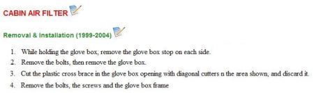

How to get to and remove/replace the filter?
Thanks very much.
Is this something that a reasonably handy guy can do?
Thursday, January 14th, 2010 AT 9:59 AM
BLUELIGHTNIN6
MECHANIC
16,542 POSTS
Monday, January 25th, 2010 AT 3:54 PM
