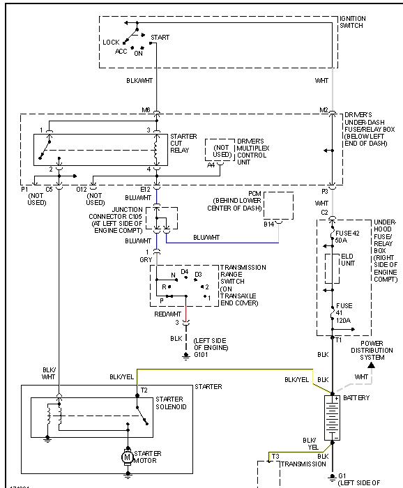

I have a 2003 honda odyssey, sometimes after putting in the key the car won't start it just keeps on humming, after removing the key and reinserting it and a couple of tries it starts. Sometimes it just starts fine.
What could be the problem?

Could be the starter cut relay hangin up or maybe the solenoid sticking on starter.

HMAC300
  • 48,601 POSTS
Doesn't sound like an engine problem more like a relay or solenoid on starter. If the engine starts thenit would kick the starter off and if either of the two previous parts wer doing what I think then it wouldn't hum but wouldn't have an easy time to keep the engine running.

So getting the starter checked solenoid/relay is the solution here.
