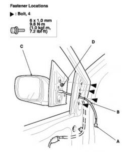

I'm looking for help in replacing my driver's side mirror. I already have the mirror in hand, just need to change it out. Thanks.

Disconnect the connector (A), and detach the harness clip (B), then remove the bolts securing the mirror. While holding the mirror (C), push out the clip (D), and remove the mirror. Be careful not to scratch the door.
https://images.2carpros.com/forum/automotive_pictures/261618_Noname4_82.jpg
To install: Install the power mirror in the reverse order of removal, and note these items: Make sure the connector is plugged in properly. Attach the harness clip. Push the cover clip into place securely. Install the door panel in the reverse order of removal, and note these items: Replace any damaged clips. Push the clips into place securely. Make sure the connectors are plugged in properly, and the inner handle rod is connected properly. For 2003-04 models, reset the power window control unit, as follows: Turn the ignition switch off, then back ON (II). Move the driver's window all the way down by holding the driver's switch to the AUTO DOWN position; when the window reaches the bottom, hold the driver's window switch in the AUTO DOWN position for 2 seconds. Move the driver's window all the way up without stopping by holding the driver's switch to the AUTO UP position; when the window reaches the top, hold the driver's window switch in the AUTO UP position for 2 seconds. If the window does not work in AUTO, reset the power window control unit according to the above procedures again. On 2002-04 models, if equipped with seat heaters, check for proper operation. Check the window and power door lock operations.
