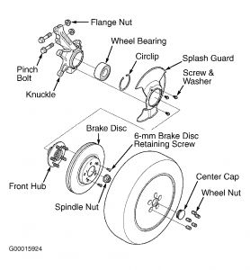

I asked for some help 2 days ago (Thurs) RE:stud replacement, and I still haven't rec'd a response. What have I done wrong?

Hello .. we are but a few among many questions .. we cannot answer all of them straight away .. sorry about that ... you will need 2 bolts to remove the disc as directed below .. you may have to strip it right down !! then knock out old stud and knock in new ... hope this helps !! Removal (Odyssey) Loosen wheel lug nuts slightly. Raise and support vehicle. Remove wheel assembly. Pry lock tab away from spindle nut and remove nut. Remove brake hose mounting bolts. Remove caliper assembly, and hang the caliper to one side with wire. DO NOT put weight on flexible brake line. Remove brake disc retaining screws. Install two 8 x 1.25-mm bolts in brake disc, and tighten bolts to force brake disc from hub. Alternate tightening of bolts to prevent brake disc from binding on hub. Disconnect ABS wheel sensor (if equipped) from steering knuckle and set aside. DO NOT disconnect sensor connector. Remove cotter pin and nut from tie rod end. Remove cotter pin from lower control arm ball joint, and remove nut. See Fig. 4 . Using ball joint remover and separate lower ball joint from control arm. Remove strut fork pinch bolts and nuts. Remove steering hub/knuckle assembly from axle shaft.
https://images.2carpros.com/forum/automotive_pictures/266999_odd_1.jpg
p.s. please try to use the reply box below when adding or replying to the same question .. many thanks
