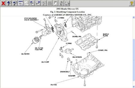

how to change oil pan , honda odyssey 2002 ande oil pan gasket?
Feb 19, 2009 at 3:05 AM
KHLOW2008
  • 41,814 POSTS
Hi rogerio2010, You need to remove anything that is obstructing the removal of the oil pan and remove all the attaching bolts. Use a wood block and a hammer to knock the oil pan to free the sealants and the oil pan can be removed.
