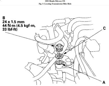

where is the transmission fluid fill located?

Hi levick, It is located on top of the trans.
https://images.2carpros.com/forum/automotive_pictures/192750_TransfillerHole01OdysseyFig03_1.jpg
