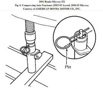

how do you reset the auto belt tensioner for your timing belt?
Jun 30, 2009 at 5:04 AM
KHLOW2008
  • 41,812 POSTS
Hi Koja_1964, NOTE: When compressing sealed auto-tensioners, compression pressure should not exceed 2200 lbs. (9800 N). Place sealed auto-tensioner in press. SLOWLY compress tensioner until pin can be inserted through tensioner body, and insert pin. See Fig. 6 . Install auto-tensioner onto engine.
