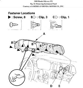

How do you remove the dash panels to replace the lamp in the clock?
Mar 17, 2010 at 12:25 AM
KHLOW2008
  • 41,814 POSTS
Hi GSchmauch, Thank you for the donation. Here are the procedures for removing the clock to replace the bulb. INSTRUMENT PANEL REMOVAL/INSTALLATION NOTE: "¢ When prying with a flat-tip screwdriver, wrap it with protective tape, and apply protective tape around the related parts, to prevent damage. "¢ Take care not to scratch the dashboard and related parts. 1. Remove these items: "¢ Driver's switch panel (see Driver's Switch Panel Removal/Installation ) "¢ Center panel (see Center Panel Removal/Installation ) 2. Tilt the steering column down. 3. Remove the instrument panel (A). â—¦ 1 Remove the screws. â—¦ 2 Gently pull out along the top to release the clips (B, C). â—¦ 3 Disconnect the hazard warning switch connector (D) and clock connector (E). With navigation system, disconnect the climate control unit connector.

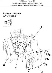

4. Install the instrument panel in the reverse order of removal, and note these items: "¢ Make sure each connector is plugged in properly. "¢ Push the clips into place securely. DRIVER'S SWITCH PANEL REMOVAL/INSTALLATION 1. Gently pull out on the driver's switch panel (A) to release the right clips (B), then detach the remaining clips (C). If equipped, disconnect the cruise control main switch connector (D), TCS switch connector (E), power mirror switch connector (F) and power sliding door switch connector (G), then remove the panel.

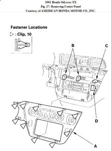

2. Install the panel in the reverse order of removal, and note these items: "¢ Make sure each connector is plugged in properly (if equipped). "¢ Push the clips into place securely. CENTER PANEL REMOVAL/INSTALLATION 1. Remove the steering column covers 2. Carefully detach the clips, then remove the center panel (A). Disconnect the heater control panel connectors (B) or climate control unit connectors, rear A/C control dial (C) (for some models) and interior light switch connector (D). With navigation system, disconnect the hazard warning switch connector, rear A/C control dial, and interior light switch connector. For '03-04 models: Disconnect the passenger's airbag off indicator connector.
