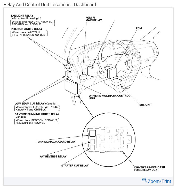

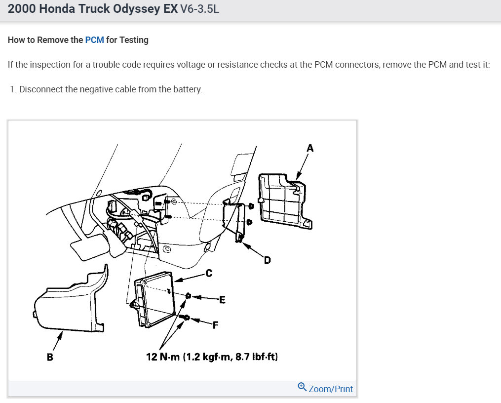

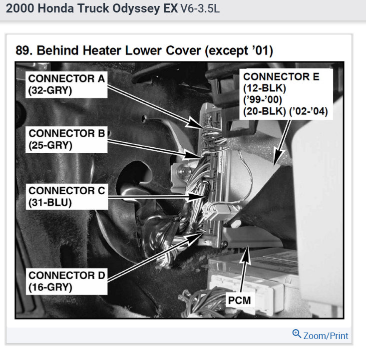

Where is computer located
2000 HONDA ODYSSEY
202,000 MILES • 6 CYL • FWD • AUTOMATIC
ZMADANAT
Also, how long does the computer last?

The computer is located behind the lower center of dash behind the heater box. Here are diagrams below that show the location. Check out the diagrams (below). Please let us know if you need anything else to get the problem fixed. Cheers

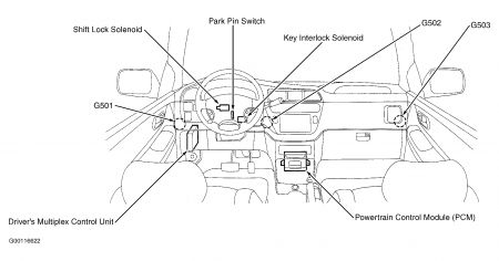

Where is the engine brain box located in the car?

https://images.2carpros.com/forum/automotive_pictures/55316_odesseypcm_1.jpg
Lower center of dash.
