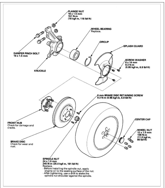

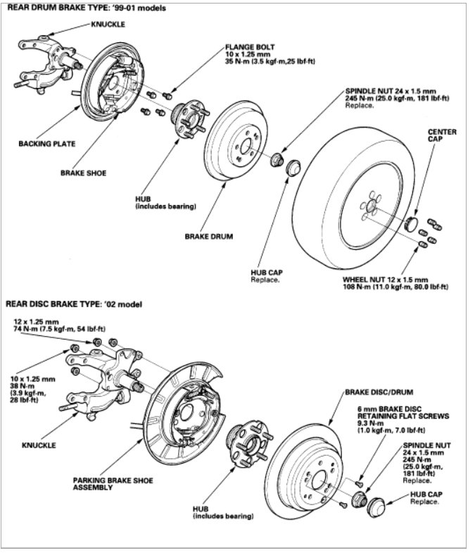

Tires and Wheels problem 6 cyl Automatic 120000 miles
How to replace broken wheel stud?
Jan 10, 2009 at 8:56 AM
Experienced Mechanic
55,500 POSTS
On some cars you will need to remove the wheel hub to replace the wheel stud.
Here is a video that show how to do the wheel stud and diagrams on how to remove the wheel hub front or rear
https://youtu.be/LSZ8P0wrQX8
Images (Click to enlarge)
