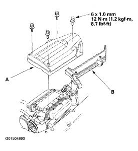

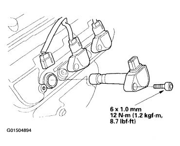

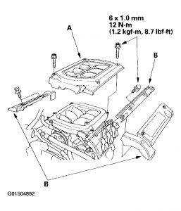

How do I access and replace the spark plugs and spark plug wires in my 2000 Honda Odyssey? I'm pretty mechanically minded and have done a lot of maintence on my other cars, but I don't even see where the plugs are on that engine.

Hi there, Thank you for the donation. This engine is fitted with coil over plug ignition, that is each plug has it own coil and there is no lead attached, you have to remove the cover plats on the top of the cocker covers and unbolt and detach the plug to each coil withdraw the coil and the spark plug is then accessible to be removed, see pics for covers & coil removal.
