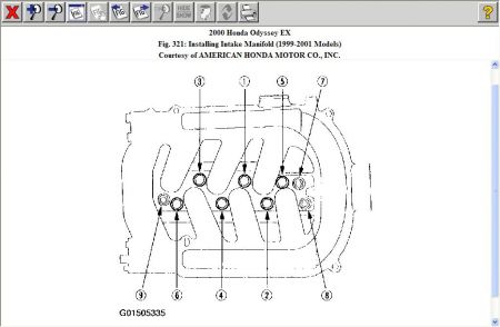

Ilike to find out The torque valiu for the bolts on the intake maniful and the torquing secuence?

Hi Mofles,
Specified torque:
8 x 1.25 mm 22 N.m (2.2 kgf.m, 16 lbf.ft)
