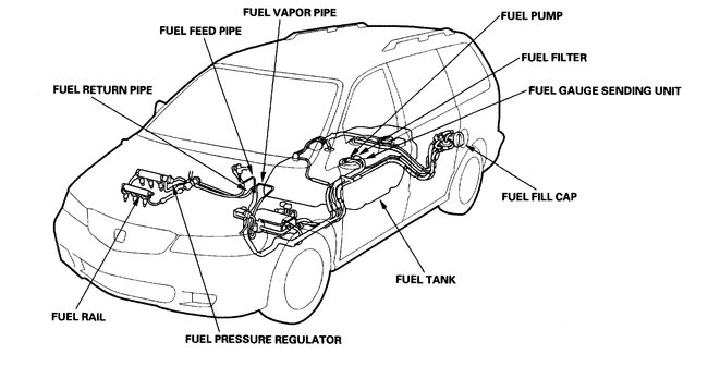

I was wanting to know where the fuel filter was so I can replace it.

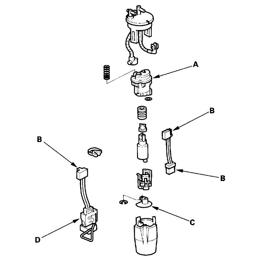

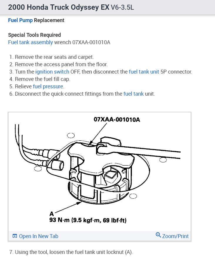

I just noticed you have the V6 model Odyssey. These models don't have a fuel filter separate from the fuel pump. The fuel filter is mounted on the fuel pump and is supposed to last the lifetime of the vehicle. The only reason to replace it would be if the vehicle has dropped fuel pressure and is running poorly.
This guide will help explain with diagrams below to show you on your car.
https://www.2carpros.com/articles/how-to-change-a-fuel-filter
There is a trapdoor to help you replace it. Check out the diagrams (Below). Please let us know if you need anything else to get the problem fixed.
