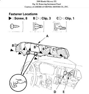

how do I get at the clock lite to replace
Dec 7, 2009 at 3:18 AM
KHLOW2008
  • 41,814 POSTS
Sorry for the delay in replying. I am surprised why I did not get any notification when you posted a reply. To get at the clock, you would need to remove the instrument panel.
https://images.2carpros.com/forum/automotive_pictures/192750_InstrumentPanel00OdysseyFig24_1.jpg
INSTRUMENT PANEL REMOVAL/INSTALLATION NOTE: "¢ When prying with a flat-tip screwdriver, wrap it with protective tape, and apply protective tape around the related parts, to prevent damage. "¢ Take care not to scratch the dashboard and related parts. 1 . Remove these items: "¢ Driver's switch panel "¢ Center panel (see Center Panel Removal/Installation ) 2. Tilt the steering column down. 3. Remove the instrument panel (A). â—¦ 1 Remove the screws. â—¦ 2 Gently pull out along the top to release the clips (B, C). â—¦ 3 Disconnect the hazard warning switch connector (D) and clock connector (E). With navigation system, disconnect the climate control unit connector. 4. Install the instrument panel in the reverse order of removal, and note these items: "¢ Make sure each connector is plugged in properly. "¢ Push the clips into place securely.
