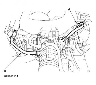

Hi there guys, where is the PCV Valve located on a 1999 Honda odyssey EX, I tried finding it but could not locate it.
thanks.

Hello and thanks for donating Your vehicle's PCV valve is under the intake manifold cover. There is a diagram below for a better view, letter A identifies the PCV valve, with B being it's hoses.
https://images.2carpros.com/forum/automotive_pictures/261618_Graphic_613.jpg

thanks for the fast and informative answer man,
makes tasks much easier than you think!
Thanks.
