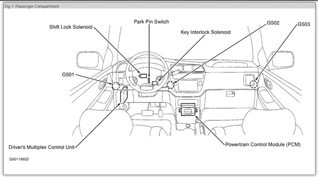

Hi ishking54667,
There are no computers in the transmission. All solenoids are on the external of the transmission. The computer for the transmission is the same as the engine computer and is located inside vehicle.
What is the problem that you are facing?

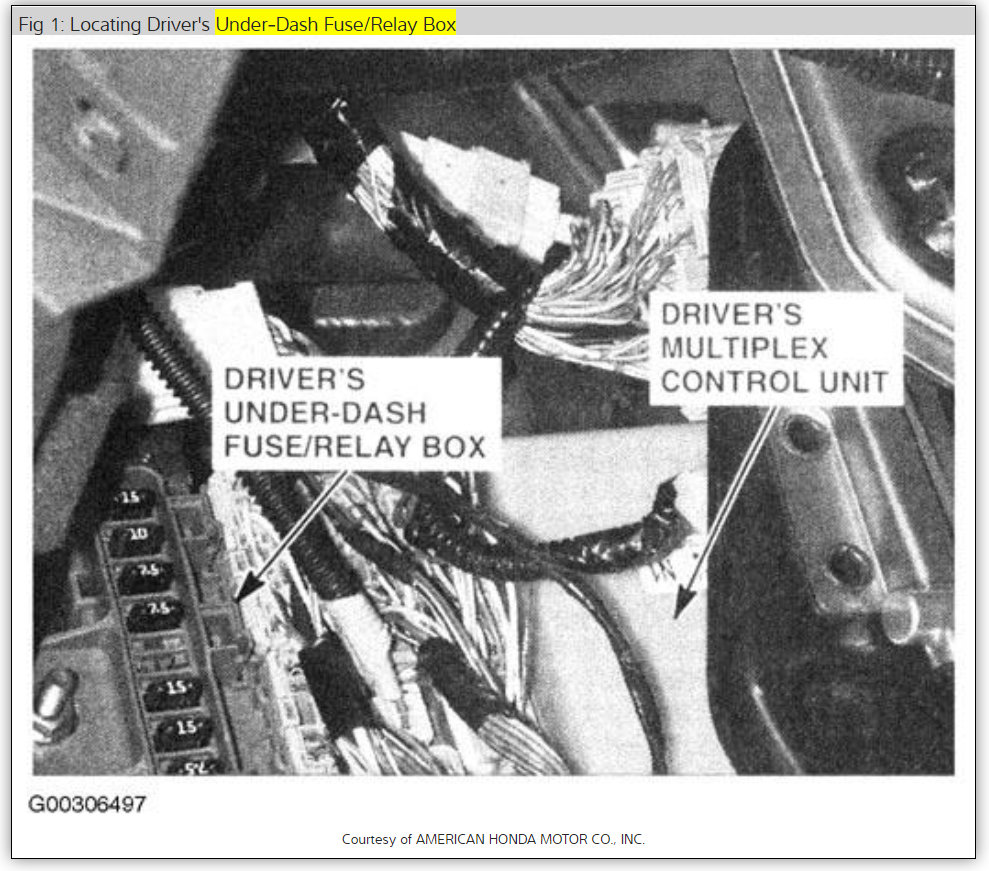

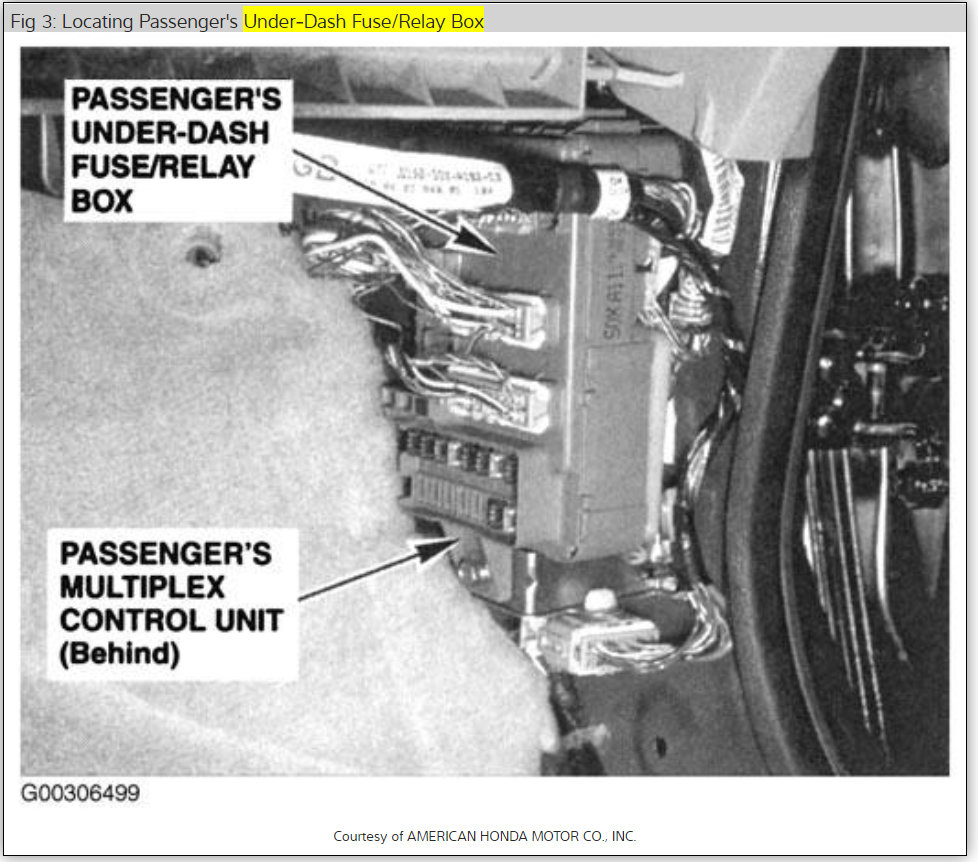

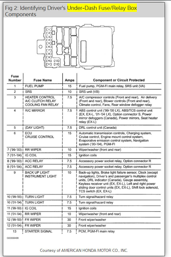

hello I have similar problem where vans drives normal for about 1/4 mile and then acts like it goes to neutral have to stop the engine and restart put back in drive and go again next 1/4 mile, fluid ok disconnected battery and still same problem any ideas?
Feb 18, 2018 at 11:11 PM
  • 55,423 POSTS

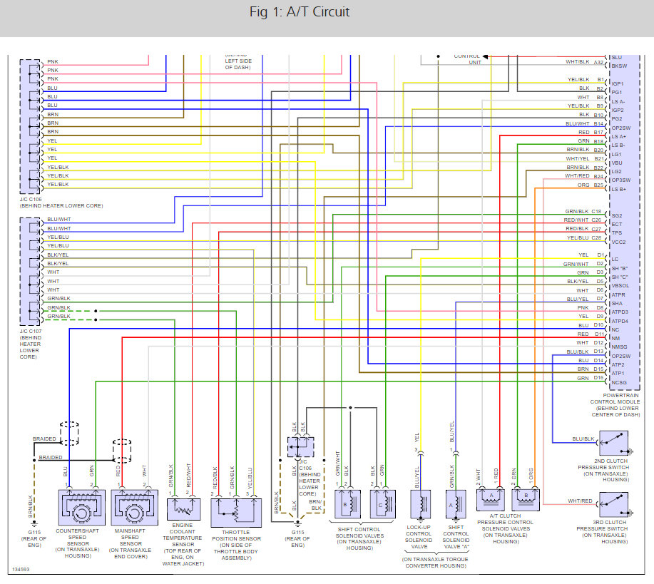

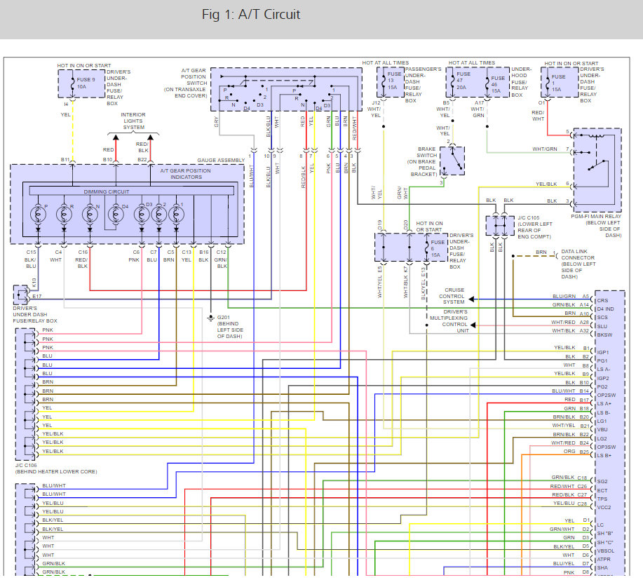

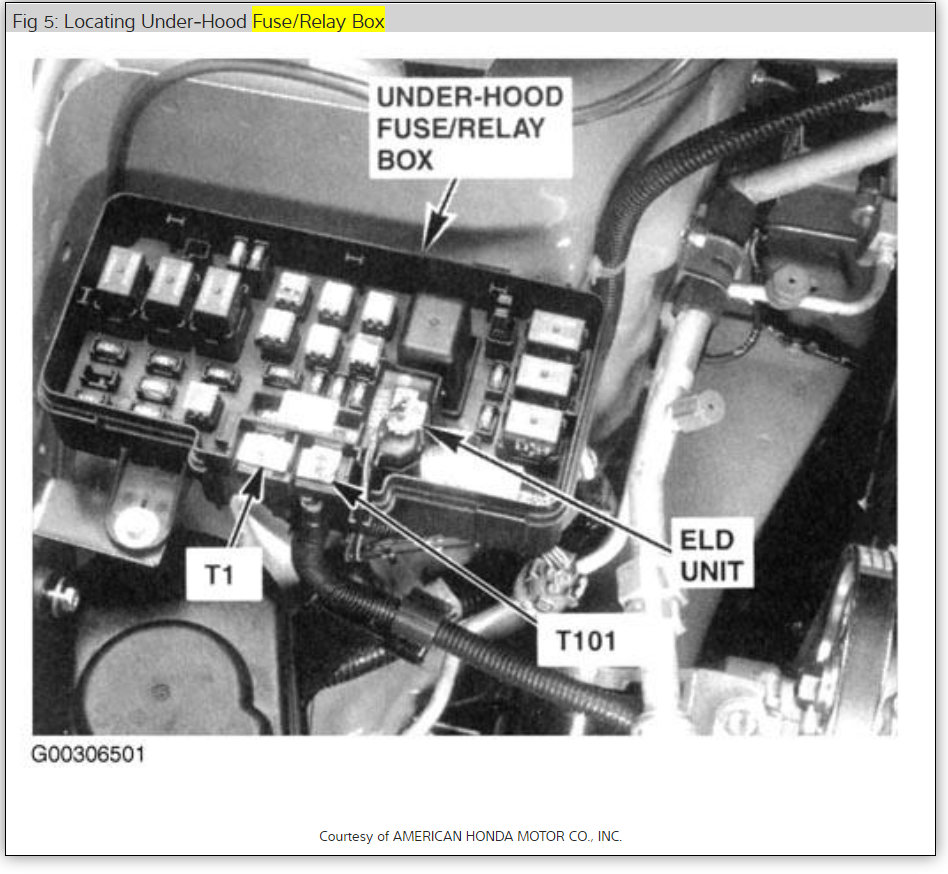

It sounds like you have a input shaft speed sensor going out. I would start by checking he fuses and run the codes first so we don't chase our tail.
and
Check out the fuse panel and ECU locations diagrams (Below)
