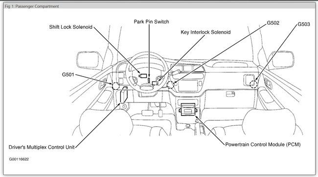

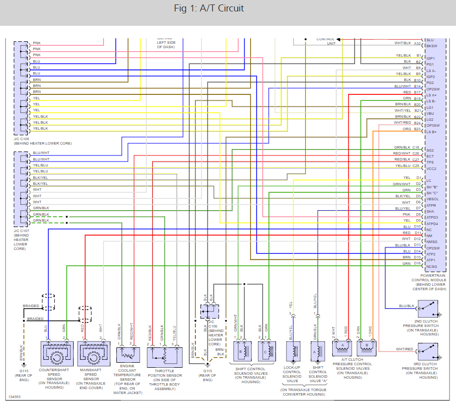

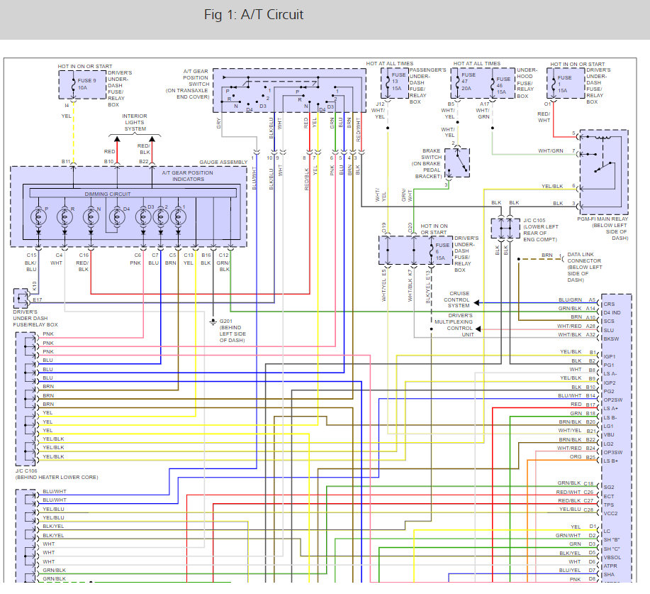

hello I have similar problem where vans drives normal for about 1/4 mile and then acts like it goes to neutral have to stop the engine and restart put back in drive and go again next 1/4 mile, fluid ok disconnected battery and still same problem any ideas?
Feb 19, 2018 at 7:11 AM
  • 54,840 POSTS

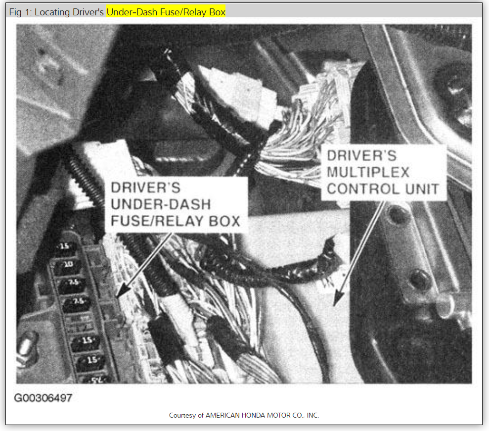

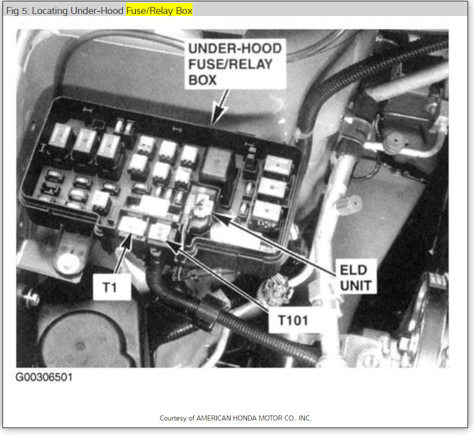

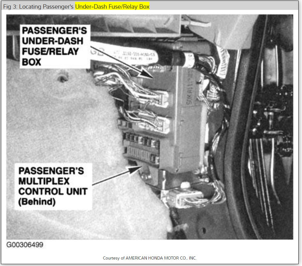

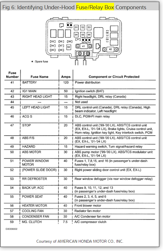

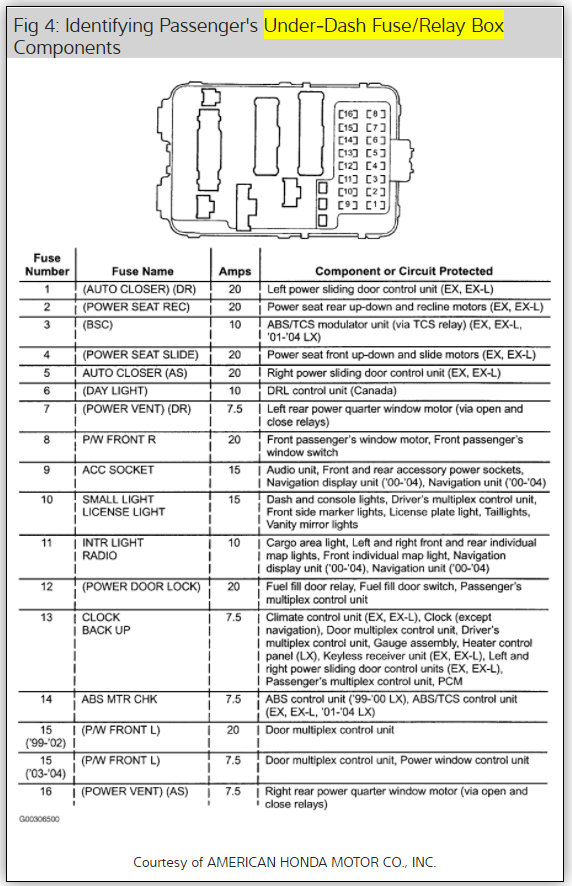

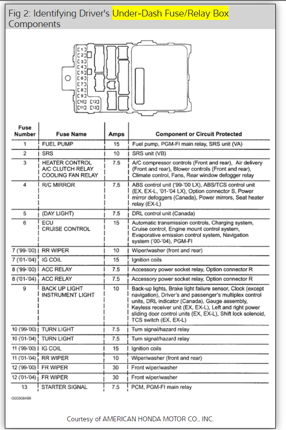

It sounds like you have a input shaft speed sensor going out. I would start by checking he fuses and run the codes first so we don't chase our tail.
and
Check out the fuse panel and ECU locations diagrams (Below)
