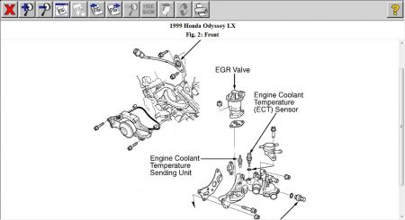

Engine light came back on and apparently the valve connected to the EGR needs to be cleaned. Any easy way to do this without having to pay a mechanic for labor time?

You can use a carb cleaner and small bore brushes and clean out the passages thoroughly.

How easy is it too access the passages on a 99 Odyssey?

The CEL coming back On does it pertain to the EGR valve? Never done one on an Odyssey-
https://images.2carpros.com/forum/automotive_pictures/12900_egr_valve_2.jpg

Not sure the exact code but it is mentioning the ERG valve and insufficient flow. The ERG valve was just replaced and my mechanic friend said that the valve passage connected to the ERG needs to get cleaned. About 1 - 2 hours work.
