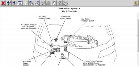

Where is the neutral safety switch located on a 1998 Honda Odyssey?
Sep 25, 2010 at 8:31 AM
  • 75,992 POSTS
A/T Gear Position Switch On lower rear of transaxle
https://images.2carpros.com/forum/automotive_pictures/12900_gps_1.jpg
