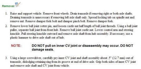

how do you change outer cv boot driver side? Can not get cv joint off half shaft

Saturday, January 30th, 2010 AT 11:36 PM
