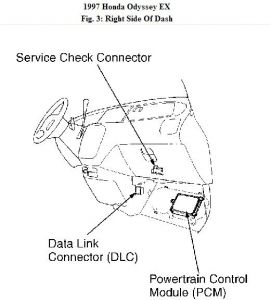

my engine light turned on a couple of days ago. I took it to autozone for a free diagnostics test and they could not find where the plug to connect the reader. Do you know where it is located.

Hi grifaldo2, DLC is located on right side of dash. On left side of front passenger's footerll area.
