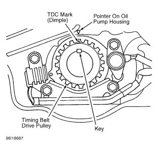

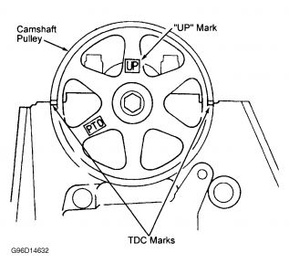

Helping a friend with his timing belt replacement.....the book is showing obscure timing marks.......so far we have the camshaft set where the valves of number 1 cylinder are closed. If we then set the crank pulley with keyway pointing up, will that be correct timing? So far, our settings have produced zero compression at number 1 cylinder. The engine ran ok before.......water pump was bad. Help!

Hi there, Timing marks for crank & cam as per pics. Mark (mhpautos)
