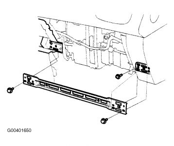

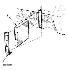

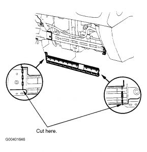

How do you get at the ACC filter to replace it? I know it is behind the glove box. Does the glove box swing down some how? (Honda Insight)
Thanks
May 1, 2008 at 2:29 PM
KHLOW2008
  • 41,814 POSTS
Hi eyeofhonda, Glove box and central lower cover removal required if equipped with AC system. Cut and dispose the plastic base in Fig 1.
