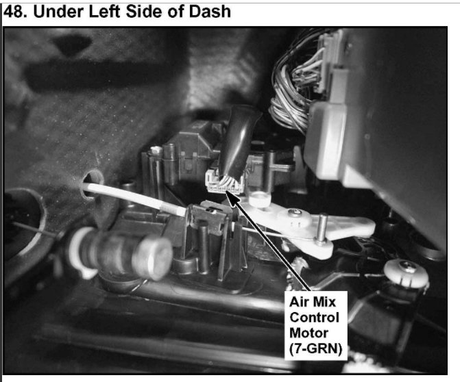

KUNIO
Hi, Paulrcohen. Thank you for replying.
After the all research, I found self diagnosing program which showed #7 (air mix control motor is open). Now, I need to replace it. I have to figure out hot change it.
Dec 14, 2017 at 1:21 AM
  • 55,647 POSTS

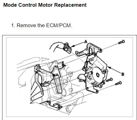

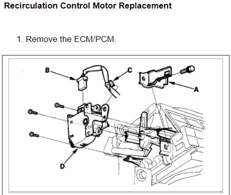

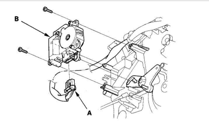

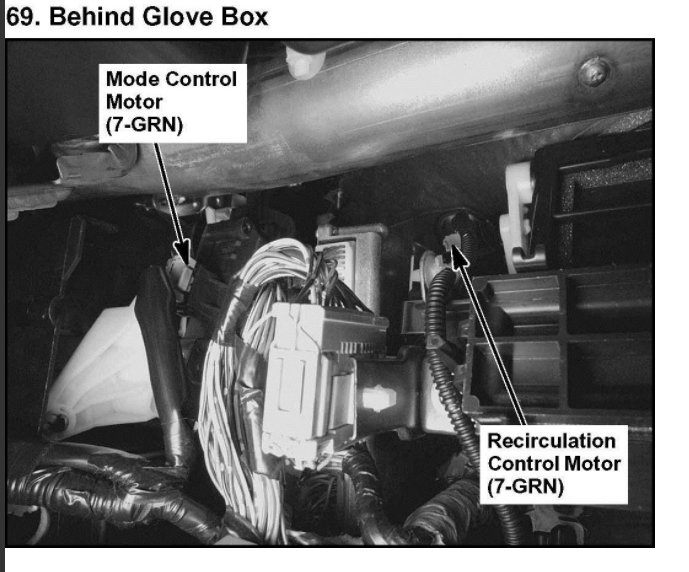

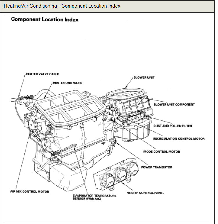

This is a common problem with this car Here is a guide that will show you what you are in for when doing the repair.
Here are diagrams to show you what it will be like on your car (Below) I gave you all blend door actuators to to give you an idea of all locations.
Dec 17, 2017 at 8:05 AM
