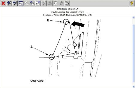

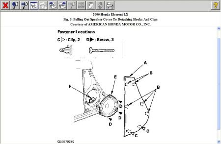

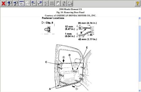

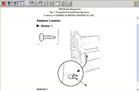

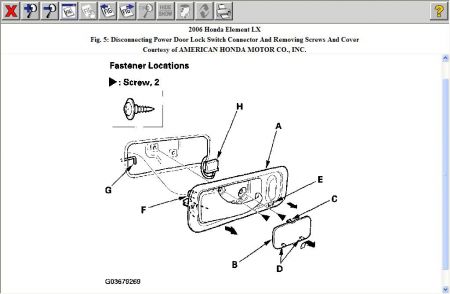

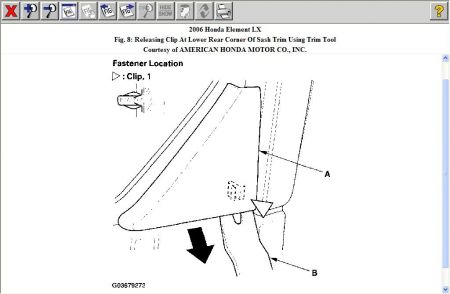

How do I remove the passenger side door panel? My window is off-track.

Hi bturley05, Hope the diagrams helps.
https://images.2carpros.com/forum/automotive_pictures/192750_DoorPanel01Element06_1.jpg
https://images.2carpros.com/forum/automotive_pictures/192750_DoorPanel02Element06_1.jpg
https://images.2carpros.com/forum/automotive_pictures/192750_DoorPanel03Element06_1.jpg
https://images.2carpros.com/forum/automotive_pictures/192750_DoorPanel04Element06_1.jpg
https://images.2carpros.com/forum/automotive_pictures/192750_DoorPanel05Element06_1.jpg
https://images.2carpros.com/forum/automotive_pictures/192750_DoorPanel07Element06_1.jpg
