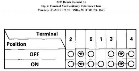

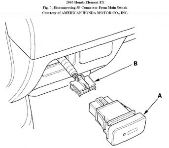

Battery was DEAD. Replaced it and now the cruise control does not work. Is there a way to reset the cruise control?

Here are the testing procedures for the main switch. CRUISE CONTROL MAIN SWITCH TEST/REPLACEMENT 1. Release the clips of the switch and push the switch (A) out of the panel, then disconnect the 5P connector (B) from the main switch.
https://images.2carpros.com/forum/automotive_pictures/192750_CruiseControl05ElementFig07_1.jpg
2. Check for continuity between the terminals in each switch position according to the table. If there is no continuity, replace illumination bulbs (A) or the switch.
https://images.2carpros.com/forum/automotive_pictures/192750_CruiseControl05ElementFig08_1.jpg

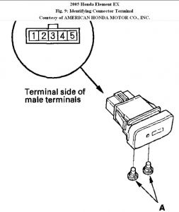

https://images.2carpros.com/forum/automotive_pictures/192750_CruiseControl05ElementFig09_1.jpg
Ensure there is battery voltage at terminal #1 ( Black/Yellow wire when ignition switch is turned on.
