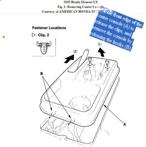

I just tried turninb my heater on yeaterday and got cold air. I just had the car 120k service the day before. no leaks noticed and the air does blow. i checked a/c off/ dialed to heat and cabin and defrost and nothing. Also bought a light bulb for the light by the shifter. how do I remove cover to replace bulb

I'll see what I can find on the shifter.

https://images.2carpros.com/forum/automotive_pictures/30961_hon1_2.jpg
