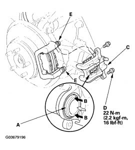

my sons element has no groves to use rear caliper tool, can i use my c clamp to back those calipers back into the caliper

yes that's correct, they just push in .. they do not twist with a caliper piston tool..
https://images.2carpros.com/forum/automotive_pictures/261618_Graphic_511.jpg
