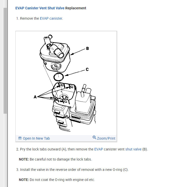

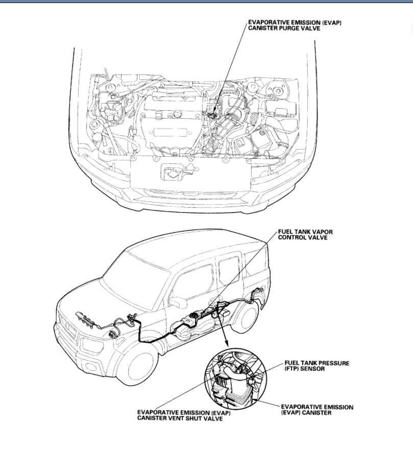

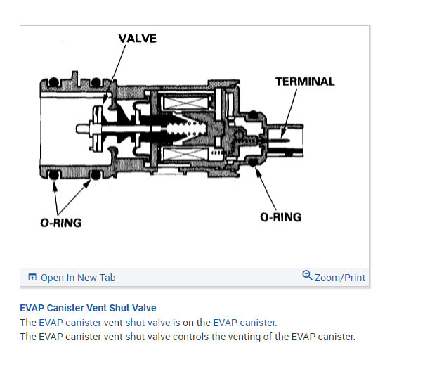

where is this valve, and can I make the repairs myself
Nov 2, 2009 at 4:29 AM

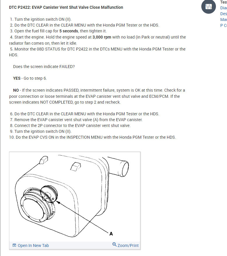

You can make the repairs yourself but we should run through this testing first to find out what the actual issue is.
There are a number of things that can cause this but in order to run through this testing we need a scan tool capable of doing this testing.
Please run through the info below and let us know if you need other info and we are happy to help.
Thanks
