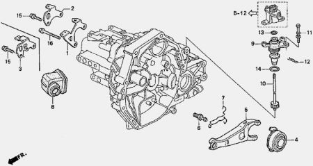

I replaced the throw out and pilot bearing. The throw out bearing mounts to a arm/lever which is pushed by the rod on the slave cylinder. No the arm was not replaced as you just install the new bearing on to it. Although I did have to take the arm off to fit the new TOB. There was some confusion with a tension/retainer clip. But I put it on the best it made sense to me as I couldn't find any pics or info on the web. I'm thinking that was why it has been so soft, and why I am where I am now... Figures 4,5,6, and 7.

I am sure there is a proper way to install the retainer but I am not familiar with such a device. Lets see if another tech here can answer your question; one who knows your particular setup well.

KHLow2008 is right has to be TOB hitting cover but why? You say it ran about 100 m then pedal started screwing up then the knock now it's like engaged all the time. When you got the flywheel back from the machine shop where there four dowel pins in the flywheel?

The flywheel bolts backed out and was hitting the clutch! The infamous "Chilton" manual for 96-00 civic/del sol's; under torque specs lists the flywheel mounting bolts at 47ft. lbs. Honda them selfs says 67ft. lbs. Have to order new flywheel bolts and run a tap through all 6 crank threads. Its a odd size tap also. Not in any craftsman kit, etc... It is a M12-1.25 "extra" fine thread tap. So, here we are...
