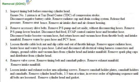

My '95 Del Sol 1.6L DOHC engine has a blown head gasket and I want to fix it but - here's the stupid part - I can't seem to locate the head bolts.
Are they located under the camshafts?
Any help is appreciated.

Hello and thanks for the donation! See if this removal steps help you locate those hidden bolts :)
https://images.2carpros.com/forum/automotive_pictures/261618_Noname_1343.jpg

Yes, thank you for your input. As suspected, the head bolts are located underneath the camshafts so, the cams had to be removed. Odd but, Honda has a reputation so, I guess they did it that way for a reason (save space etc.)
Thanks again!
