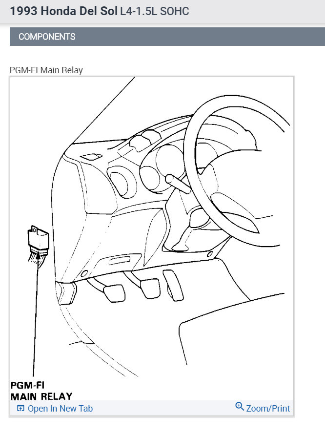

Main PFI relay location
1993 HONDA DEL SOL
11,000 MILES • 4 CYL • FWD • MANUAL
ALEXANDER KOVER
Several years ago I became aware of a common issue with Honda starter relays in hot weather. The engine turns over just fine but it fails to fire. I believe that I developed this problem when I moved to Philadelphia from Buffalo. Where is this relay under the dash, so that I can spray it with a CO2 fire extinguisher to cool it down the next time it happens?
May 27, 2010 at 11:37 AM
KHLOW2008
  • 41,814 POSTS
Hi Alexander Kover,
What you are referring to is no the starter relay. It is the Main PFI relay
It should be the PGM-FI main relay that you are referring to. The problem with the relay is that some soldered circuits are cracked and intermittently fails due to the weather.
Here is a guide to help test it with the location below.
