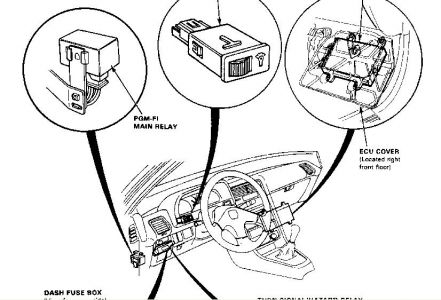

sometimes when i start to crank engine, it want fire up, it will turn over, but i pour some fuel in the intake and it will finally fire up and run,,,,doesnt do it everytime just on occasion....

Hi baconcane, Check the PGM-FI main relay. It is known to intermittently cause the fuel pump to stop working.
https://images.2carpros.com/forum/automotive_pictures/192750_PGMFIRelay90CRX_1.jpg
Resoldering the circuit board works.
