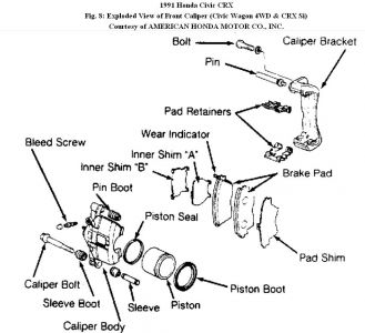

How do I replace my front brake pads. How many bolts holds the caliper on

You need to remove the lower slider pin (caliper bolt) holding bolts and flip the caliper upwards to gain access to the brake pads.
