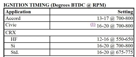

When accelerating the engine is under strain so there is insufficient time for fuel starvation to set in. When down shifting, engine rpm shoots up quickly so a minor clogging would be noticeable.
When ignition timing is too advanced, it would have a good low end acceleration but when it nears the max power rpm range, it would tend to hesitate/pull back. Downshifting at high speed would require high rpm.
Ignition timing should be set only at the correct idling speed. A higher idling speed would have a more advanced igntioon timing so if the idling speed is incorrect, you would not get the correct ignition timing.
https://www.2carpros.com/forum/automotive_pictures/192750_IgnitionTiming90Honda_1.jpg
PCV should have minimal vacumn feel and there is a spring loaded check ball inside. If covering up the PCV reduces the idling speed to minimal, then it is faulty and should be replaced.
No worries about any comments. If you think we have made a wrong judgement, please let us know. To err is human and sometimes we might have read or interpreted the question wrongly. At times we might not have expressed ourselves clearly so any pointers are always welcomed.

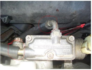

Thank you for the more indepth insight on the fuel filter, I belive the throttle isnt ajusted on the intake by a screw like most vehicles and is done with vaccumes, the only ajustment I found was on the EACV and it will only raise the idle and not lower it because it is allready pulled back, I re-traced all lines and are functional, im going to try the fuel filter and look for a change
The pvc is good still and has a line running to it that if disconencted almost kills the engine?
Is that good or bad? It runs from the top of the pvc to the intake manifold, ill upload some photos for refrence.
Tuesday, March 24th, 2009 AT 10:37 AM

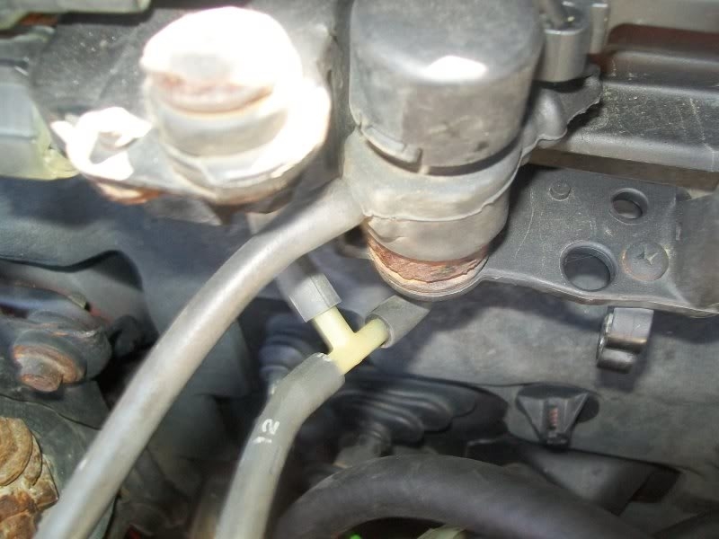

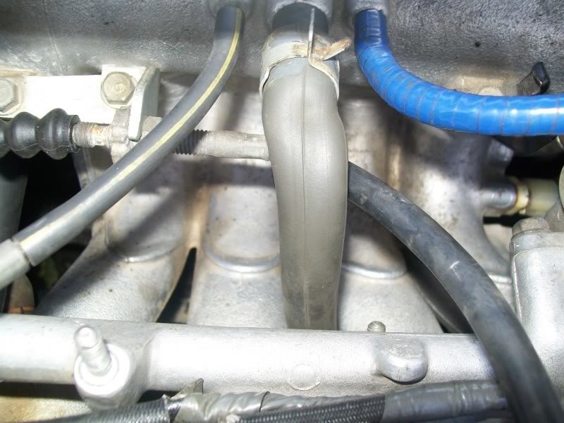

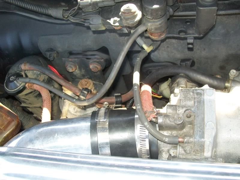

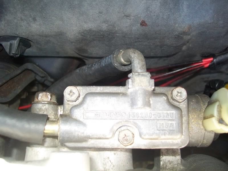

1990HONDACRX
  • 11 POSTS

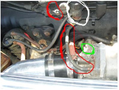

Here are photos of the vaccume lines that run from the pvc to a sensor then down to the intake manifold.
(picture 3)
also is a photo of the EACV wich is ajusted to the lowest idle for cold conditions I belive is what its for.
(picture 4)
the one that shows the front of the intake is the middle hose that runs down under the manifold into a box, it has a signifact purpose wich I dont know what it is because without it attathed to the manifold the engine would run excessively high
Tuesday, March 24th, 2009 AT 11:04 AM

The red circled hose is for the MAP sensor ( red circled Black item )
The white circle is the purge solenoid and it should be getting vacumn from the maniflod, the blue hose that you have on the manifold.
The green circle has the idle adjust screw.
https://www.2carpros.com/forum/automotive_pictures/192750_a90Civic1_3.jpg
The 2 hoses are coolant hoses which I dont see any clips and are loose, guess you did not connect them correctly. Without coolant passing through the EACV, the idling speed would be high and inconsistent.
The EACV is factory set and should not be adjusted. It could cause irregular idling and idling speed fluctuation when AC is turned on and off.
https://www.2carpros.com/forum/automotive_pictures/192750_a90Civic2_2.jpg
+1

No ac in the car anymore, was pulled out when I bought it, and no coolant flows through the lines, they seem to be just in a circular path, possible coolant bloackage mabye.
The blue line runs from my Fuel pressure regulator to the intake manifold, should they be connet in a t patter like these lines are and the map sensor should be seperate running only to the manifold?
Purge selenoid should run to the manifold-
Map sensor should run to the manifold-
EACV should recieve coolant from engine-
(took cap off EACV and there isnt any hole for coolant to reach internal sensor, just seems like a circular route.)
Will look for idle screw again and see if I can find it,
and re run hoses like explained.
Will update as soon as I run through the parts and check to see if re-routing helps. Thank you for more insight, I owe you big time,

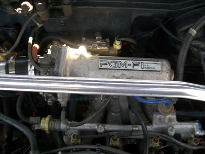

https://www.2carpros.com/forum/automotive_pictures/333708_100_0578_1.jpg
Above is full shot
https://www.2carpros.com/forum/automotive_pictures/333708_th_fenders_1.jpg
Here is the full car photo of whats been my project for the last 6 months, purchased for 350$, invesyed 700$

Without coolant passing through the EACV, the idling speed might act a little weird when engine is warming up. There should be joints for the hoses on the thermostat housing and water pump passage under the manifold, unless the parts were replaced without those.
The MAP sensor vacumn should be isolated from others as the vacumn port is specifically for it and any disruption in the vacumn would cause the MAP sensor to provide incorrect signals to the ECM.
Instead of the fuel regulator vacumn hose, use the other Black hose with a T connector, which is connected to a dash port vacumn.
