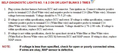

Computer problem
1987 Honda CRX 4 cyl Front Wheel Drive Manual
pgm-fi lite stays on lites 2 & 1 are lit up on computer what does this mean?

It sounds like you have an issue with the wiring between the MAP sensor or a faulty MAP sensor itself. Below are diagnostic steps to take to pinpoint the issue.
https://www.2carpros.com/forum/automotive_pictures/261618_Noname_79.jpg
