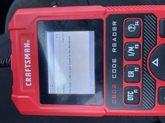

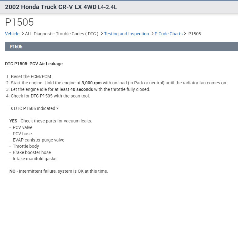

The code P1505 is for PCV air leakage.
Have you reset the engine light to see if it comes back on?
This code can be due to leaking/lose PCV hose, faulty EVAP canister purge valve, Throttle body issue, leaking brake booster hose, intake manifold leak.
Try resetting the ECM. If the light exists after the reset procedure, then it could be one of the issues mentioned above. If the light goes off, then it just needs resetting.
I have attached the procedure below.

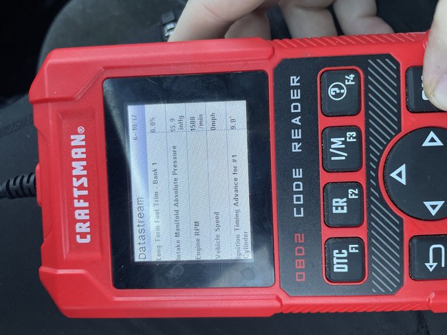

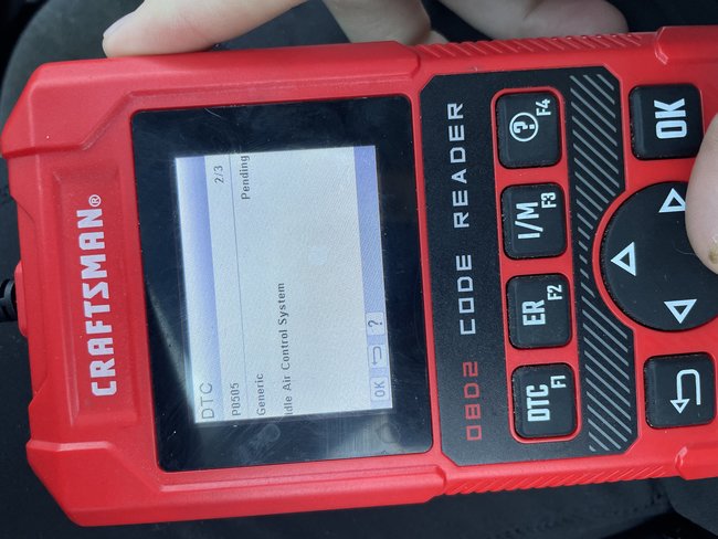

It is now reading p0505 and p1505. The idle is reading at 1,500-3,000 RPMs at various stages in driving. Whether it be driving or if it is in park. When I go to turn the car on or off, it spikes to 4-6,000 RPMs. I have replaced many of the sensors, I have had professionals check for vacuum leaks twice.

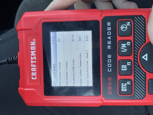

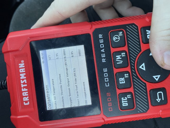

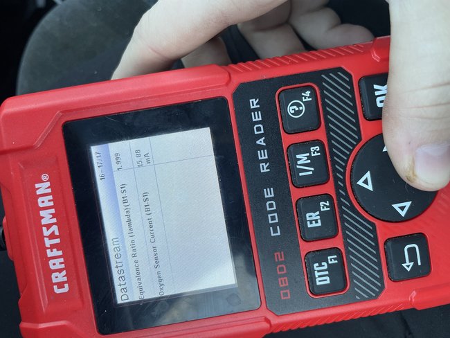

These are the codes it is reading and the levels they are showing based on the status of the car.
