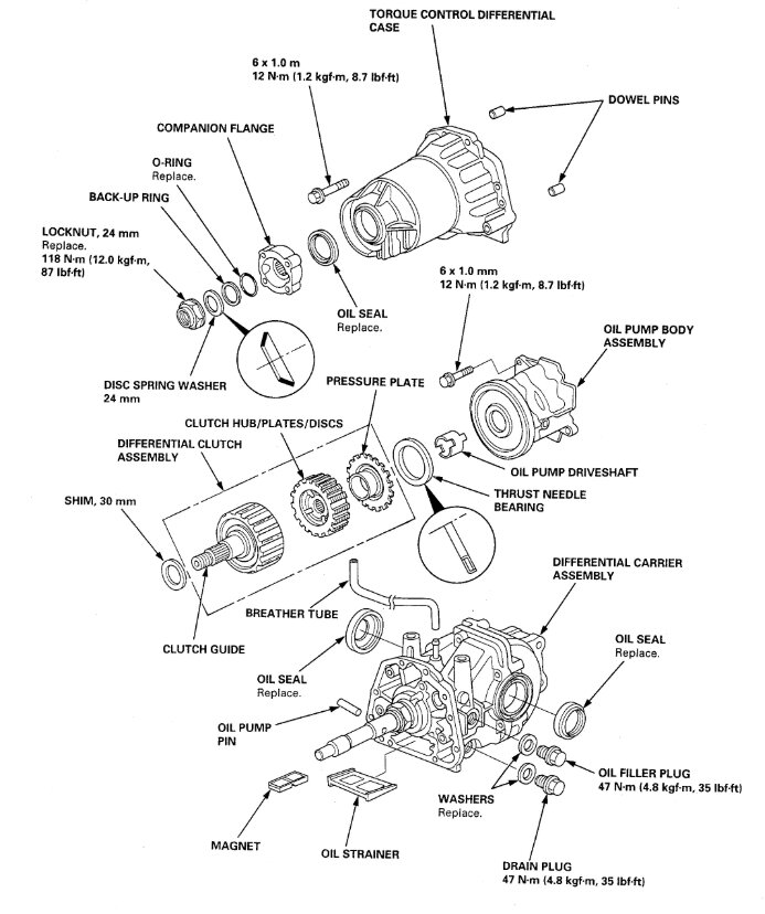

Hello , i see you had same problem with front differential leaking on Honda MK1. I also replaced o ring but it has continue to leak at exactly same spot as yours. Did you find problem later?

Where is the differential is it leaking? At the axles or? Can you upload an image? Here is an exploded view of the rear differential so we can be on the same page. Check out the images (below).
