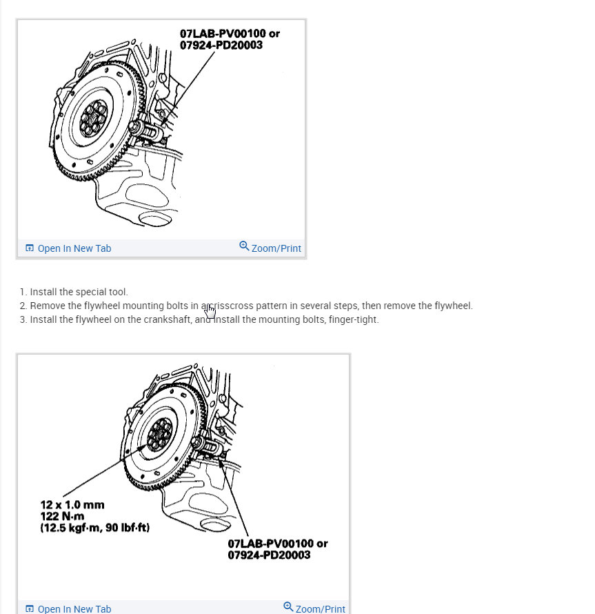

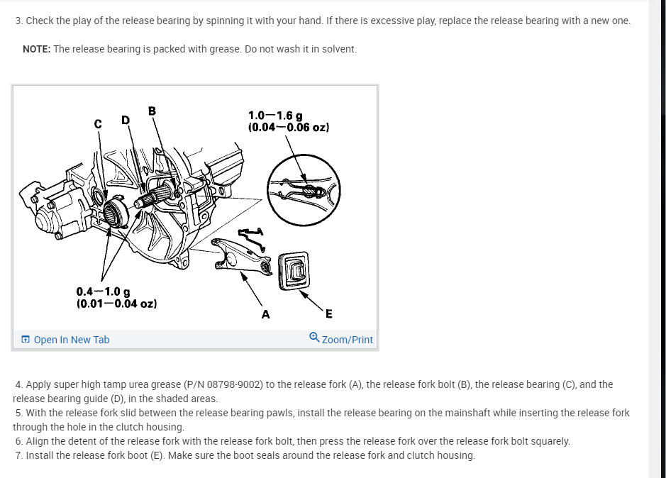

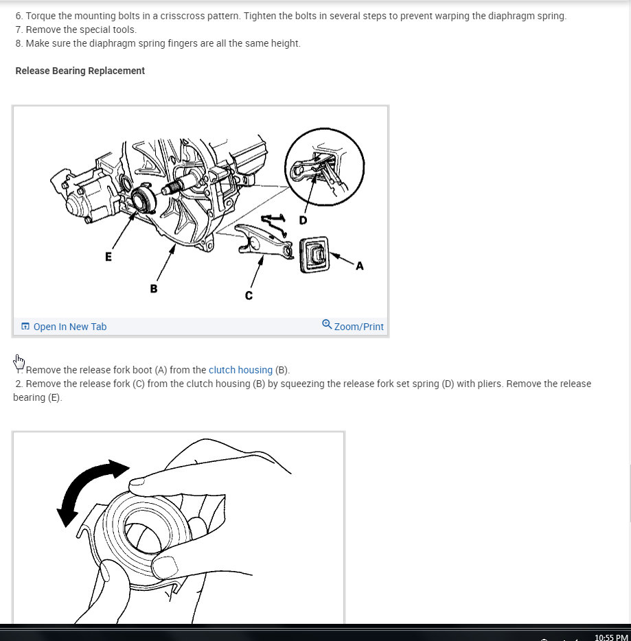

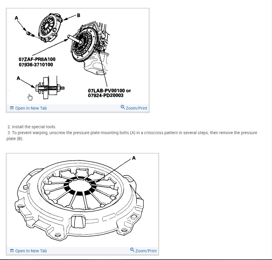

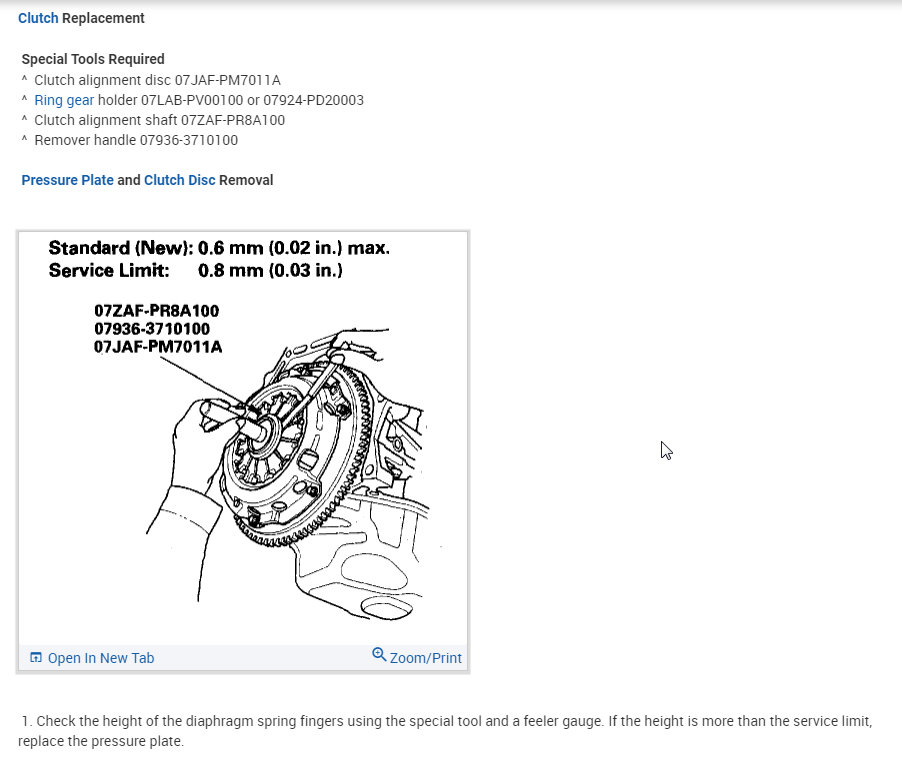

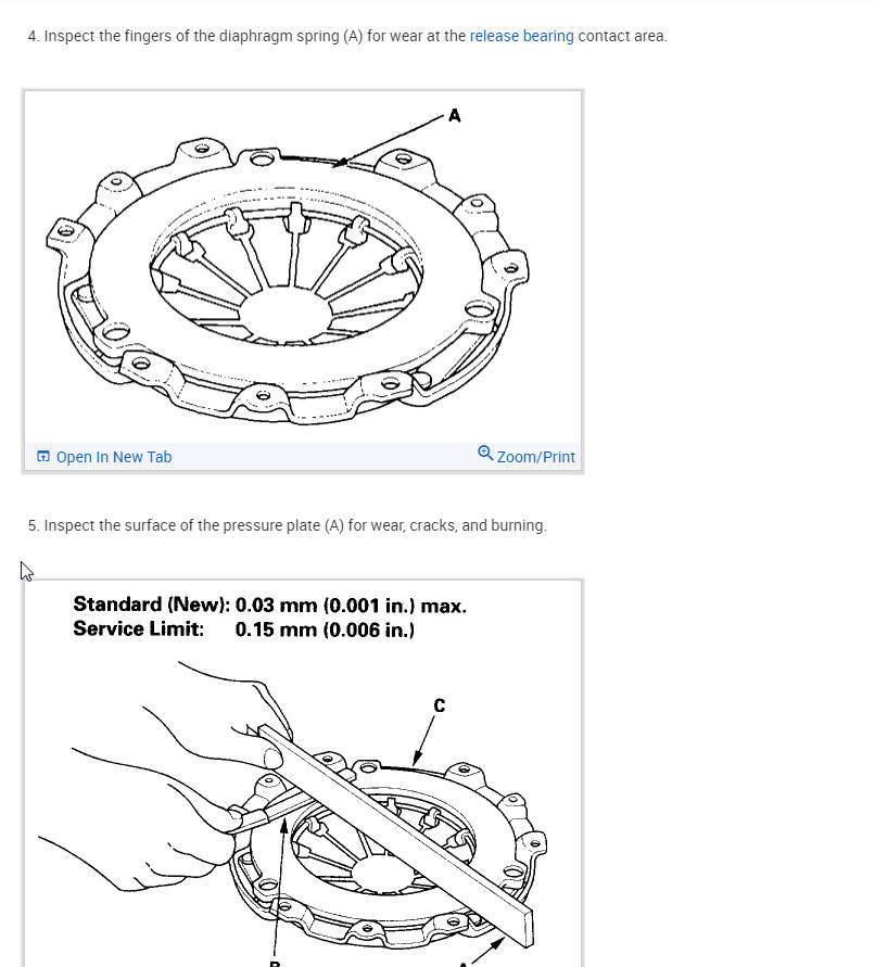

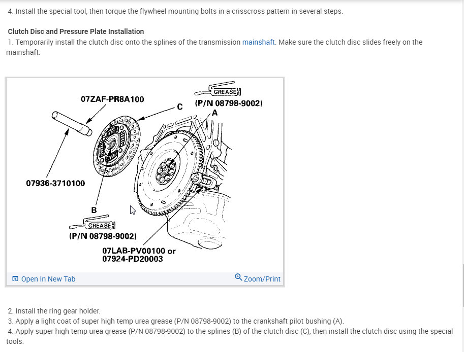

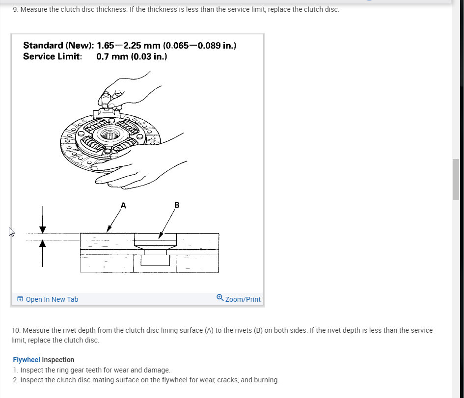

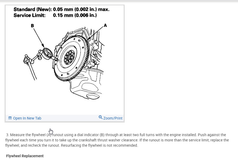

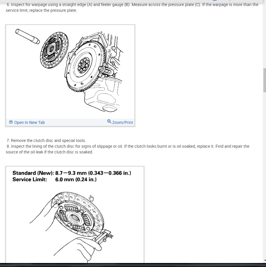

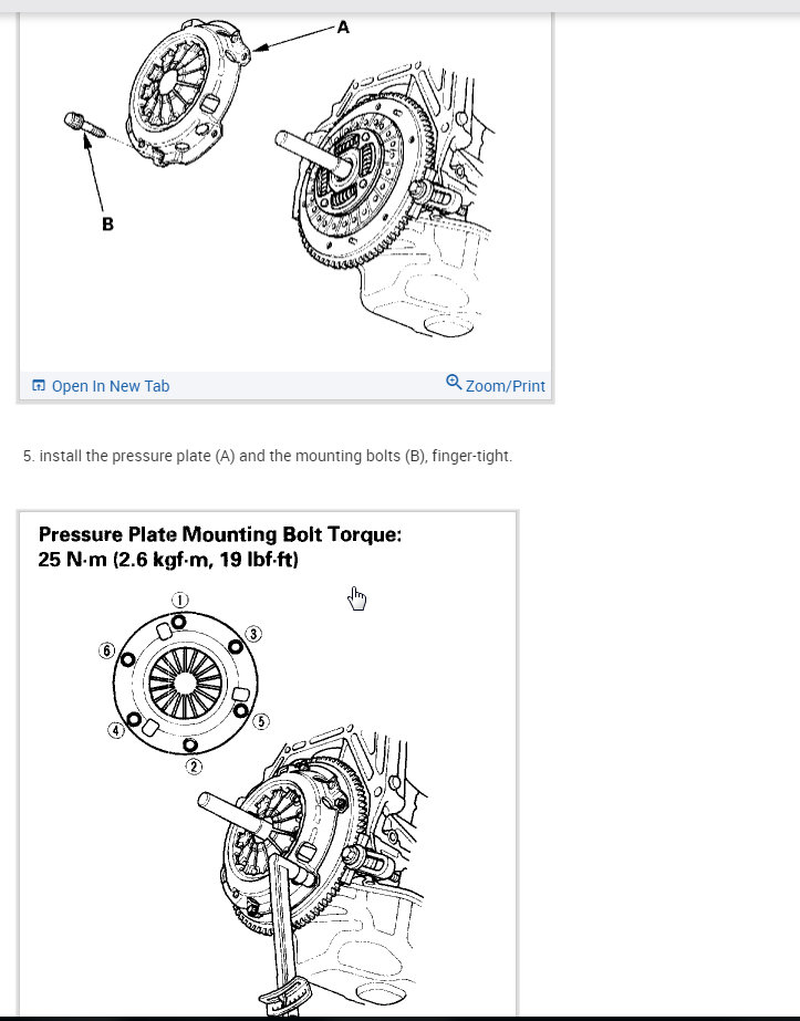

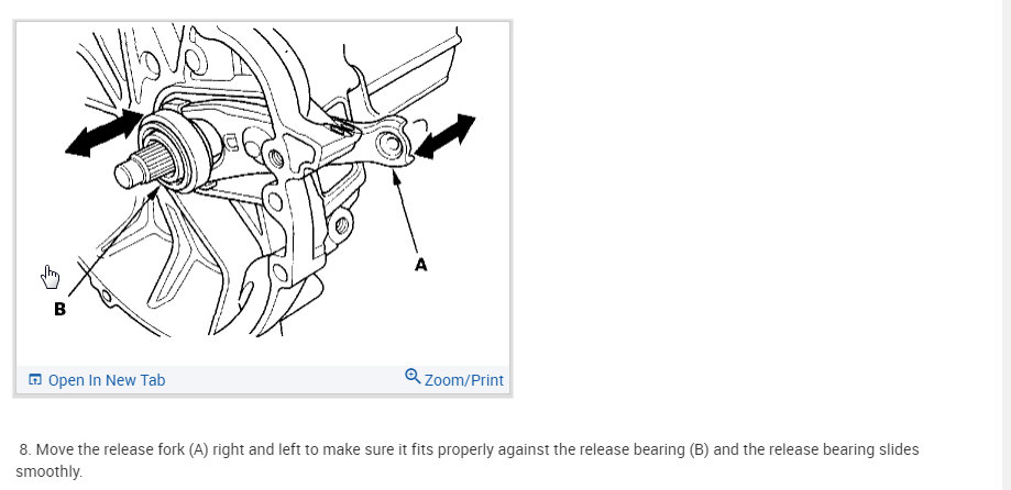

Grinding and hard to engage/disengage gears are the two most common causes of a failing clutch and/or hydraulic system. When you add the chatter that you are feeling, I would just go ahead and replace the clutch and related components.
https://www.2carpros.com/articles/clutch-symptoms
Let me know if you have questions but you have quite a few symptoms of needing a clutch.
