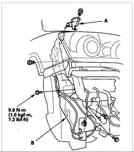

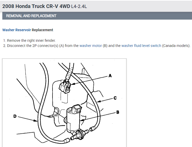

windshield washer quit working. Wipers work but not washer. Is there a fuse and where is it located. I looked at two fuse panel locations and cannot find one.

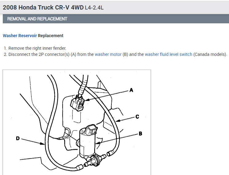

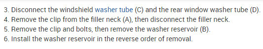

Here is the information you requested. After looking at the fuse diagram for your car I couldn't find a fuse for the window washer motor. It sounds like it must be a failed or burned out window washer motor. I've attached picture steps below on how to remove and replace the window washer fluid reservoir to replace the washer motor which is attached. Hope this helps and thanks for using 2CarPros.
