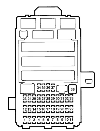

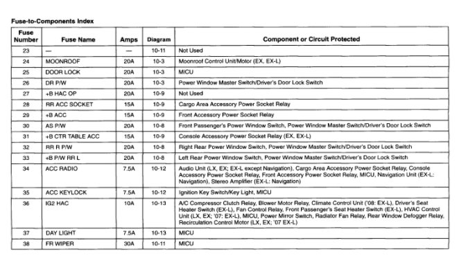

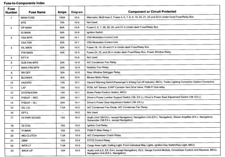

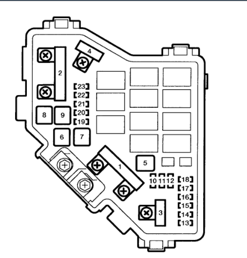

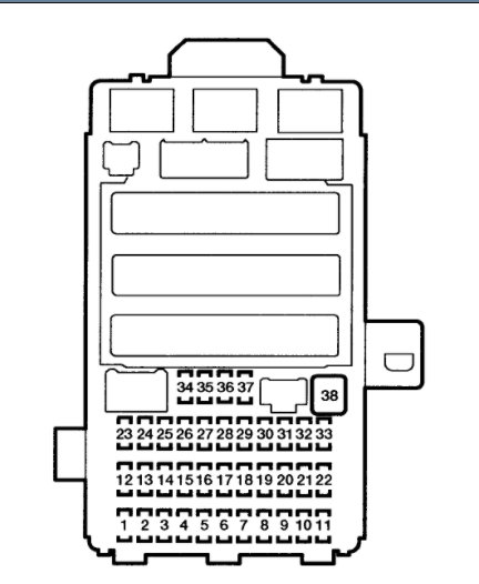

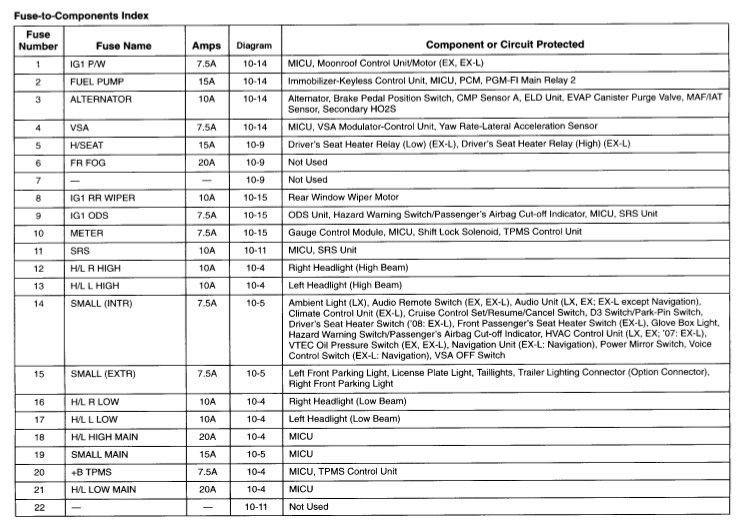

The outside lights are not working in my car can you help me test the fuses and give me the locations please?

Hello, I'm Danny.
Here is the information you requested. Here a few tutorials for you to view on how to check and replace fuse:
I've attached pictures below showing the fuse and relay locations on your vehicle. Hope this helps and thanks for using 2CarPros.
