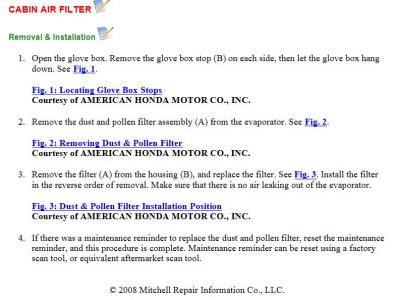

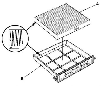

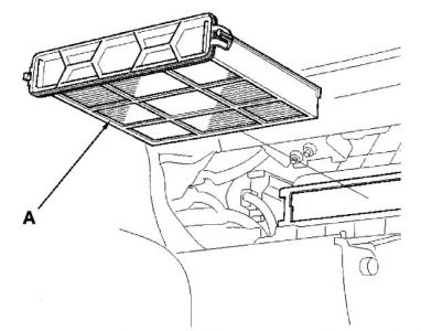

how do i locate my air cabin filter?
Mar 19, 2009 at 3:43 PM
KHLOW2008
  • 41,814 POSTS

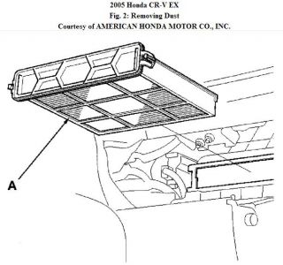

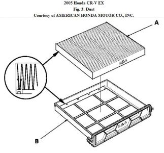

Hi ferrerdavid, Here are the removal and installation procedures.
https://images.2carpros.com/forum/automotive_pictures/192750_CabinFilter07CRVa1_1.jpg
https://images.2carpros.com/forum/automotive_pictures/192750_CabinFilter07CRV01_1.jpg
https://images.2carpros.com/forum/automotive_pictures/192750_CabinFilter07CRV02_1.jpg
https://images.2carpros.com/forum/automotive_pictures/192750_CabinFilter07CRV03_1.jpg

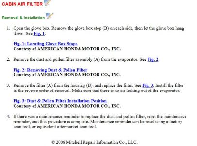

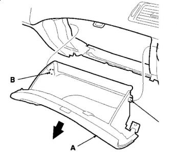

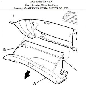

Would it be the same for a 2006 Crv? There was a major design change between the '06 and '07. Thanks
Apr 18, 2009 at 10:07 AM
KHLOW2008
  • 41,814 POSTS
Hi dgrames, This is for 05 model which is equivalent to 06 and designs are similar 07 models.
