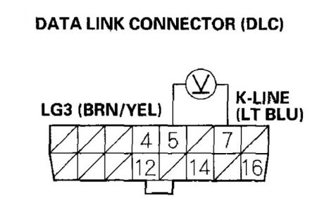

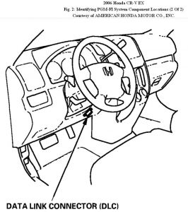

I am sharwan from fiji a technican, i have problem in crv a check engine light is on i do not have scanner bt i want to know that how can i do self diagnosis and i do not know where is the location of diagnosis connector. hope you will help me

Hi Sharwan,
https://images.2carpros.com/forum/automotive_pictures/192750_DLC06CRVFig02_1.jpg
For older models using a jumper across the terminal 4 and 8 would enable you to read the CEL flashing codes. For this model you might have to jump between 4 and 7.
https://images.2carpros.com/forum/automotive_pictures/192750_DLC06CRVFig02a_1.jpg
