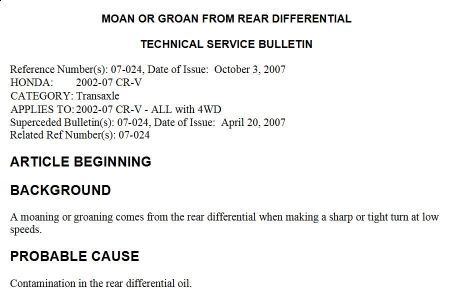

I believe the noise is emitted from the rear differentials and this is a common problem for CRV.
Replacing the rear differential fluids would solve the problem. Only the recommended Honda DPSF - II fluid should be used. Any other fluid would cause the grating noise.

The groaning noise would be transmitted to the front via the propeller shaft.
There was a TSB on the problem and maybe you could check with your local Honda dealer if it is a warranty problem.

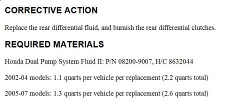

KHLOW2008
  • 41,814 POSTS
Here are the TSB information.
https://images.2carpros.com/forum/automotive_pictures/192750_TSBRearDifferentialCRV01a_1.jpg
https://images.2carpros.com/forum/automotive_pictures/192750_TSBRearDifferentialCRV01b_1.jpg
