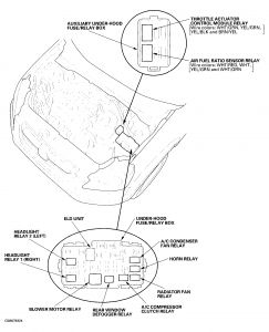

A/C works fine until I come to a stop then it seems as if it is getting warm and not cooling leading me to think the A/C condenser fan is not coming on.
I dont hear it or do I see it coming on if I set for awhile with the motor running and I have the hood up.
Checked fuses and they are OK
Is there a relay?
If so where is it and how does one check it?
If no replay then is the fan motor the issue?
Any input or help surley appricated and will save me a bundle at the Honda dealer.
Thanks

Hi Ken,
When the compressor is working, the condenser and radiator fans must both be working.
https://www.2carpros.com/forum/automotive_pictures/192750_CRV2005FuseBox_1.jpg
To test the fan motor, remove relay and bridge constant power source terminal with fan wire.

I checked the relay and they seem to be working ok.
One fan is coming on ( the one on the right if you are standing in front of the car looking into the engine conpartment) the one on the left side is not coming on.
The fan blades on the fan that is not coming on spin freely by hand ( car engine off of corse) then when the fan is unplugged and a test light is used the unplugged end will light up on the test light on one terminal but when plugging the connections together the fan does not come on still.

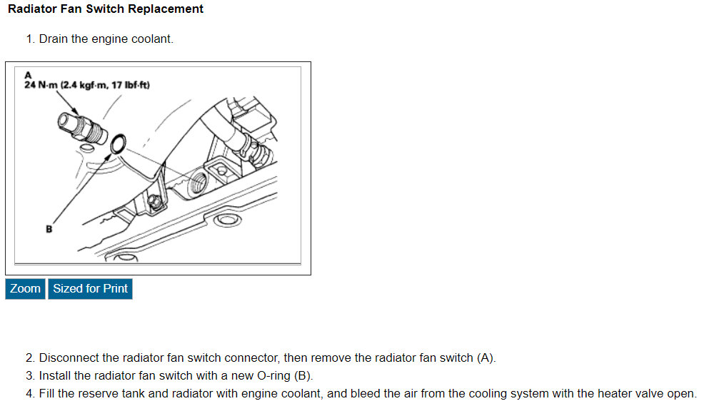

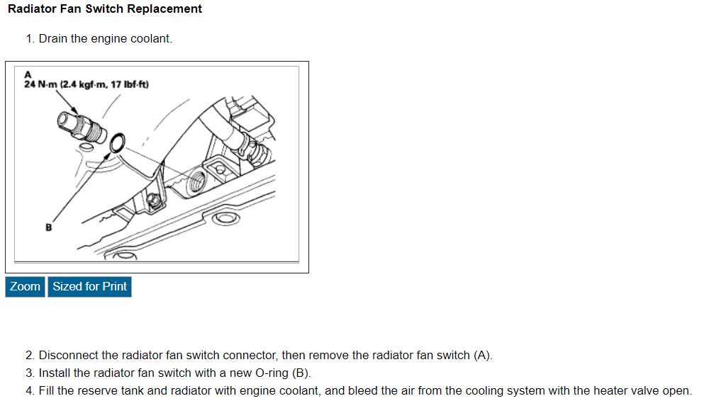

Hi Ken,
Yes, both fans should be working when the AC compressor is working or the operating temp is reached to activate the fan switch.
Here is the location of the temperature sensor for the fan which is in the bottom of the radiator.
Cheers
+1
Monday, August 11th, 2008 AT 7:13 PM
PRIOR60
  • 6 POSTS
That did the trick thanks for the help on this problem I love this site.
