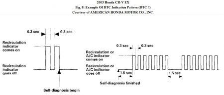

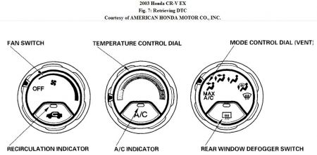

Hi w_noel_smith, You can perform simple checks to understand what could possibly be wrong. When A/C is turned on, check if the cooling fans are working and the compressor is engaged. How to Retrieve a Diagnostic Trouble Codes The Heater Control Panel has a self-diagnosis function. To run the self-diagnosis function, do the following: 1. Turn the ignition switch OFF. 2. Turn the fan switch OFF, the temperature control dial on Max Cool and the mode control dial on Vent. 3. Turn the ignition switch ON (II), then press and hold the recirculation control switch. Within 10 seconds while holding the switch down, press the rear window defogger switch five times. The recirculation indicator blinks two times, then the self-diagnosis will begin. If there is any problem in the system after self-diagnosis is finished, the recirculation indicator will blink the Diagnostic Trouble Code (DTC) 7 through 13. When problems in the evaporator temperature sensor circuit are detected (codes 14 and 15), the A/C indicator will blink the DTC. If no DTC's are found, the indicator will not blink.
https://images.2carpros.com/forum/automotive_pictures/192750_HVACDTC03CRVFig07_3.jpg
https://images.2carpros.com/forum/automotive_pictures/192750_HVACDTC03CRVFig08_3.jpg
Canceling the Self-diagnosis Function 4. Turn the ignition switch OFF to cancel the self-diagnosis function. After completing repair work, run the self-diagnosis function again to make sure that there are no other malfunctions. Max Cool Position Function 5. When the mode control dial is in the MAX A/C position, the heater control panel will automatically select the Recirculation mode and turn the A/C on. The recirculation switch and A/C switch are disabled and cannot be turned off in this mode. If the control panel fails to function as described, replace it.

KHLow2008 - Thanks for the very detailed instructions. I had a different problem with the A/C and was able to get a DTC code (12) using your instructions, but I do not know how to interpret it now. Where can I find this information?

Can you provide a list of DTC meanings? I am getting DTC 9.

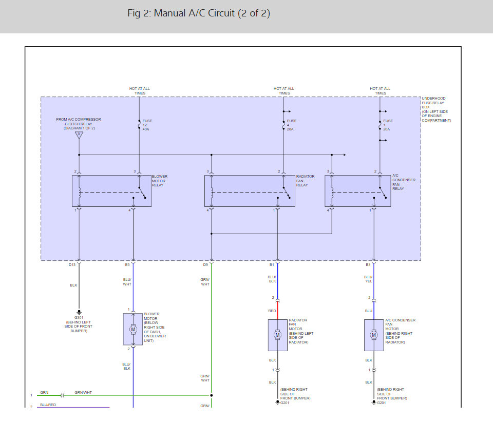

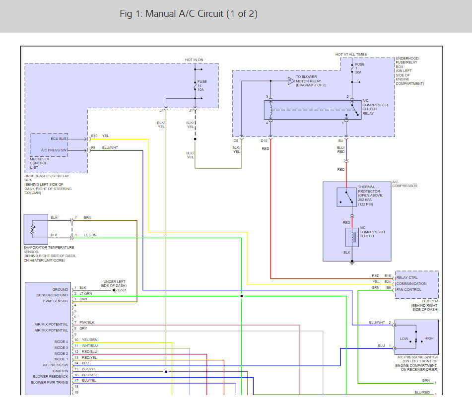

Feb 9, 2019 at 12:11 PM
  • 55,512 POSTS
Is the blower motor working? Here is a guide to help test and see what's going with the blower motor wiring diagrams so you can see how the system works:
https://www.2carpros.com/articles/blower-fan-motor-works-on-high-speed-only
Check out the diagrams (below). Please let us know what you find.
Feb 12, 2019 at 2:25 AM
RCY2019
  • 5 POSTS
Hello ken,

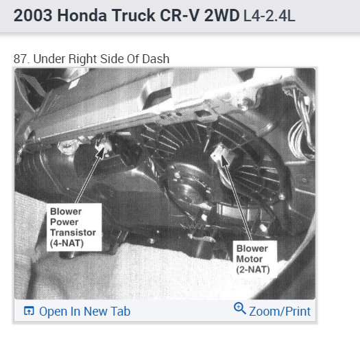

Yes I have tested the blower motor and it comes on just fine. My system is throwing a DTC 12 according to the self diagnostic I ran on the system. I have checked the fuses and again have tested the blower motor.

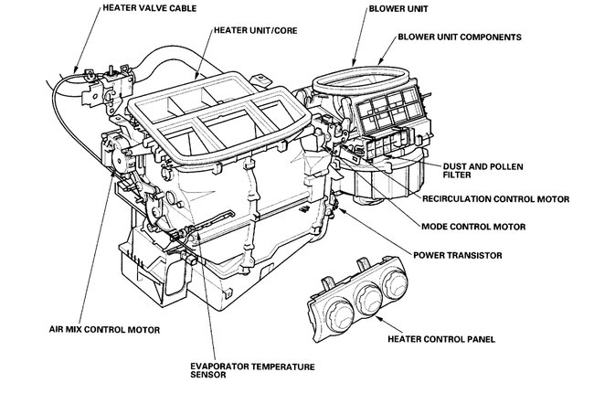

My original problem is my fan will not come one no matter what setting it was on. It was working intermittently and we noticed a relation of if we left the fan on and shut the vehicle off (fan control set on any speed) and it would not work after that. If we left the fan off and shut of the car (Fan control set to off) it would turn right on. In instances of when the fan stopped working because we had left it on, it would be months before it would start working again but once it did, and we left the fan off when shutting off the car, all was good.
Feb 12, 2019 at 10:39 AM
  • 55,512 POSTS
It sounds like the blower motor transistor has gone out. Here are diagrams to help you see the location and how to change it out. Check out the diagrams (Below). Please let us know what happens.
Feb 13, 2019 at 4:22 AM
RCY2019
  • 5 POSTS

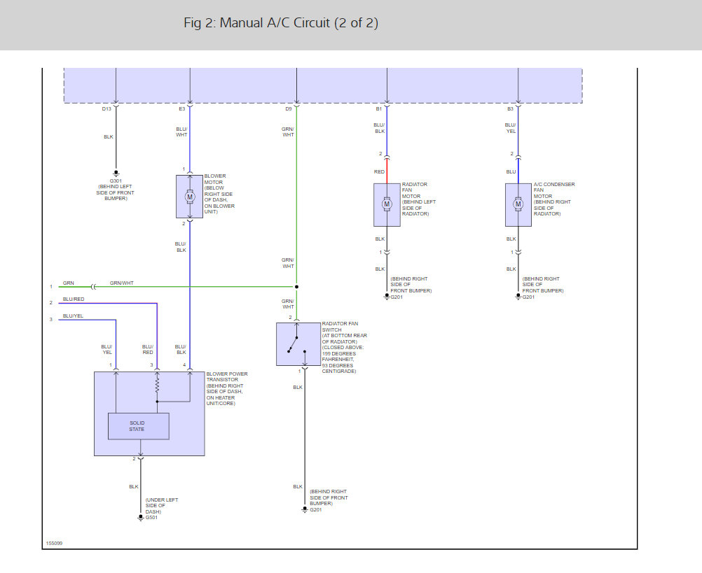

Yes, that part actually was the first part I replaced before I ran the diagnosis. it ran for a little while after I installed it but after about three days it just stopped working again. S short somewhere? I need to test the old transistor and see if it’s fine. Will try to do that tonight.
Feb 13, 2019 at 9:33 AM
  • 55,512 POSTS

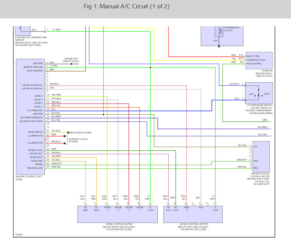

It can be the controller as well but lets check the wiring. here is a guide to help you see how:
Use the wiring diagrams from the post above.
Feb 15, 2019 at 2:23 AM
RCY2019
  • 5 POSTS
I tested the relay coming off the transistor for the blower motor.
Out of 4 I got power off of 2. The blue/red I am getting .5 volts, and I am getting .02 off the blue/yellow. The battery in the car was dead when I got too it so I started charging it before I tested. Do I need to try again once the system is charged?
Feb 18, 2019 at 6:07 AM
  • 55,512 POSTS
Yep, it sounds like the resistor is bad. did you try a new one?
Feb 19, 2019 at 2:59 AM
RCY2019
  • 5 POSTS
If you mean the blower motor transistor, then yes I have. Forgive me if I was not correct in my description. I tested the relay that plugs into the blower motor transistor. But you said resistor. that’s a different part right?
Feb 19, 2019 at 6:31 AM
  • 55,512 POSTS
No it is the same thing. We are missing something here. Can you go back over the wiring diagrams to see where you are losing power start at the fuses? Also use the guide above to check the grounds.
