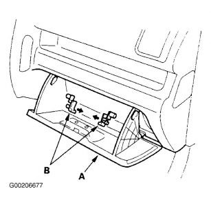

where is the cabin filter located
Aug 11, 2008 at 5:52 AM
BMRFIXIT
  • 19,053 POSTS

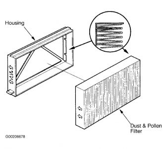

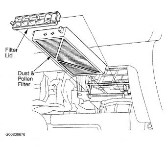

CABIN AIR FILTER -2005 Honda CR-V LX Page 1 of 1 CABIN AIR FILTER Removal & Installation 1.Open the glove box. Remove the glove box stop on each side, then hang the glove box down. See Fig. 1. 2.Remove the filter lid from the blower unit, then pull out the first dust and pollen filter. Slide the second filter to the left and pull it out. See Fig. 2. 3.Remove the filter from the housing and replace the filter. See Fig. 3. 4.To install the filter, reverse removal procedure. Ensure arrow marks on edge of filter face in direction of air flow.
