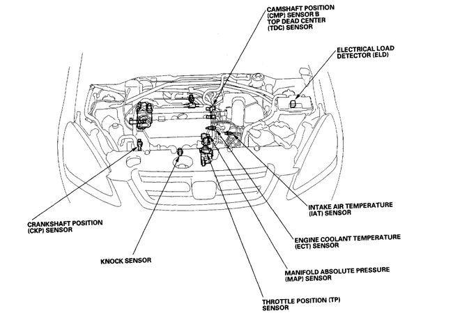

P0302 P0303 and P0304 MISFIRE?
CCOTE
  • 2003 HONDA CRV
  • 4 CYL
  • AWD
  • 172,000 MILES
Got this code recently.
Changed all spark plugs. Ho my god they are expensive.
Had the codes earased and they came back in no time.
There is many possibilitys to that problem
1. O2 sensor,
2. Fuel pump
3. Fuel filter
4. Cpu problem?
So before investing the kind of money to change all these, is there anyone who had this problem solved or do you have a good idea on it.
Thanks

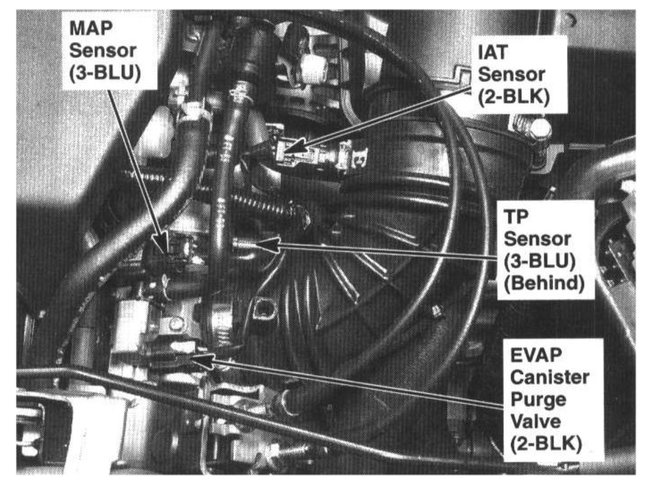

I have seen the issue before and had to replace the MAP sensor because it causes the engine to run too lean creating the misfire codes. Here is the sensor location and instructions on how to change it out in the diagrams below. Check out the diagrams (Below). Please let us know what happens.

I got a new sensor for $78.00 at AutoZone had it installed in 20 minutes then cleared the codes they never came back, car runs great.
